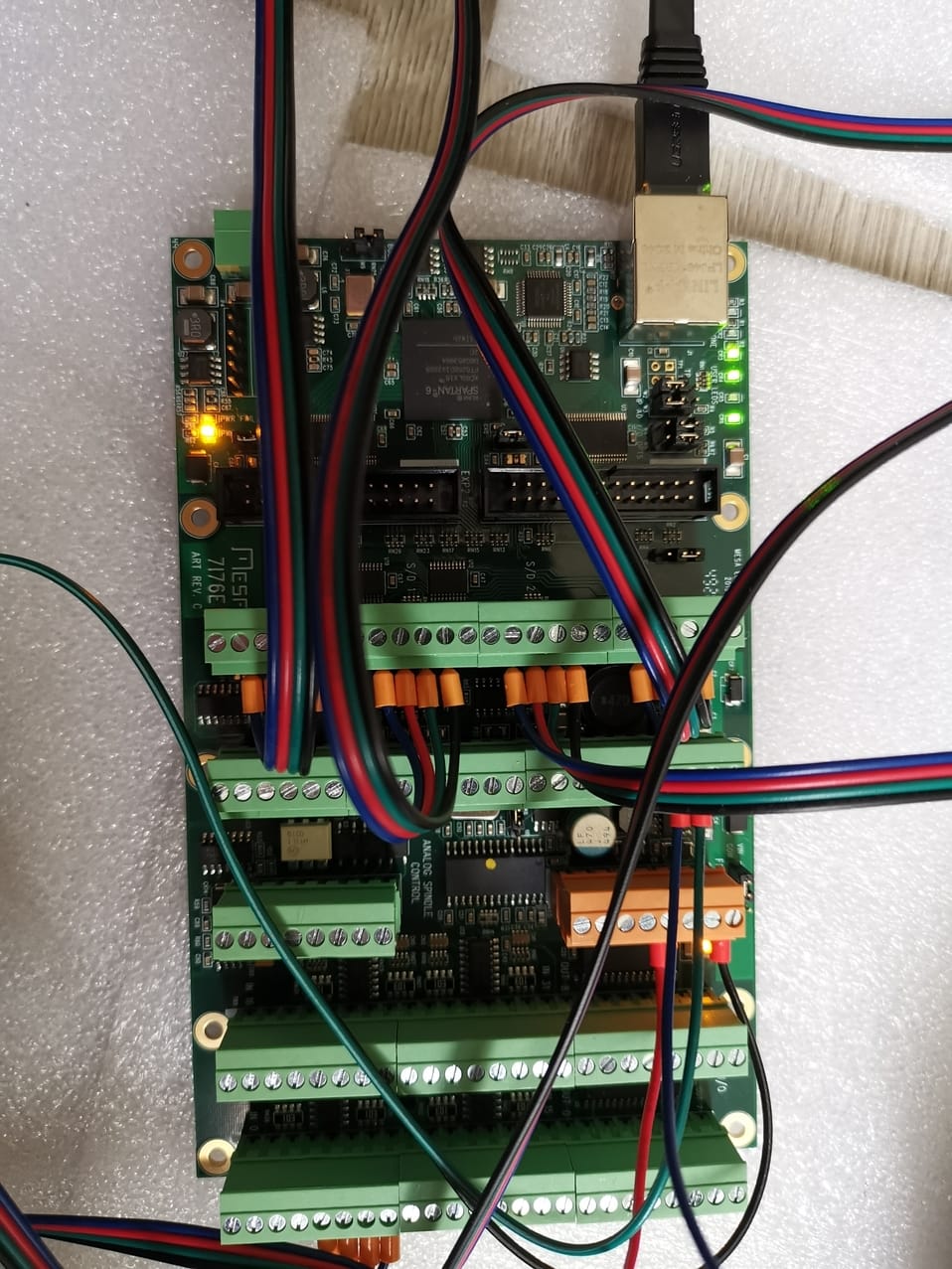

I don't want to create a new topic and was wondering. I did prolonged Latency tests and it was always around 30k. Today it jumped to 39k when i've opened web browser.
I should just use that maximum setting for configuration?
I will be using 7i76e mesa card.

10 Jul 2021 14:27 #214211
by EastRaw
Replied by EastRaw on topic Error message.
Hmmm..
Still getting this error message:

hm2_eth: ERROR: Could not retrieve hardware address (MAC) of 192.168.1.121: Resource temporarily unavailable
hm2: unloading
Debug file information:
Note: Using POSIX realtime
hm2_eth: rtapi_app_main: Resource temporarily unavailable (-11)
./my_LinuxCNC_machine.hal:9: waitpid failed /usr/bin/rtapi_app hm2_eth
./my_LinuxCNC_machine.hal:9: /usr/bin/rtapi_app exited without becoming ready
./my_LinuxCNC_machine.hal:9: insmod for hm2_eth failed, returned -1

I think that i'm doing something wrong with my MESA card connection. Jumpers or a certain wire... It wasn't connecting to anything so i've created connection and than tried to ping the card.
I simply got: No 7i76e card connected or something like that.
Did i connected something wrong?

This is what i get.
