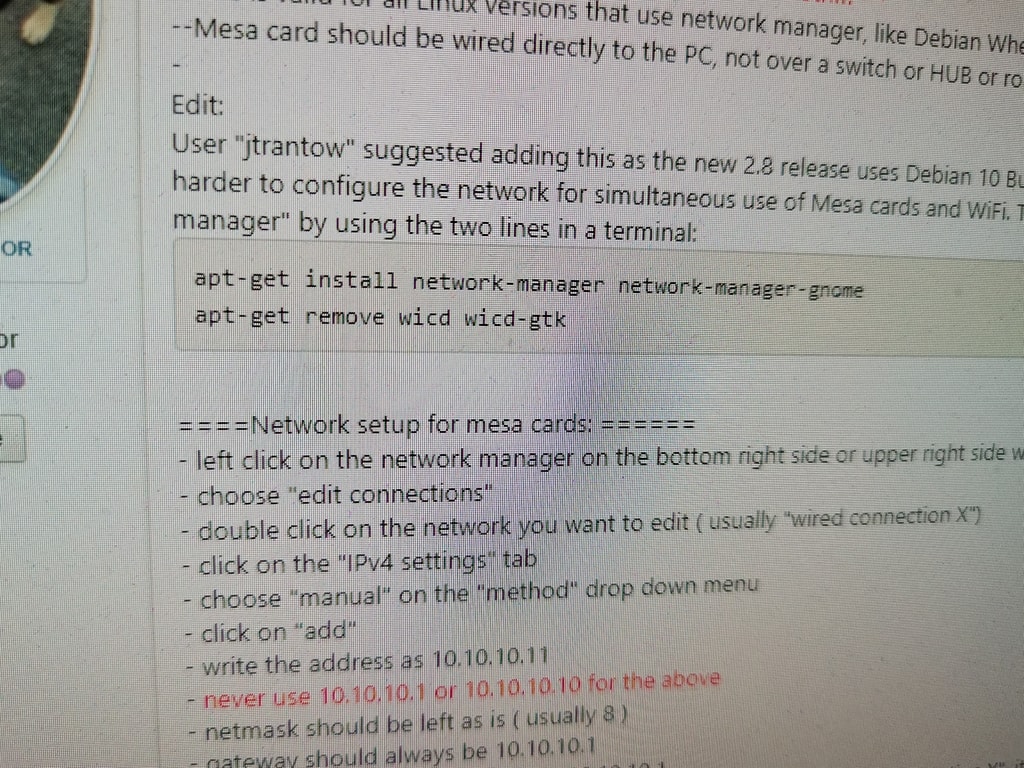

11 Jul 2021 09:47 #214267
by EastRaw
Replied by EastRaw on topic Error message.
I've used instruction in the picture and installed those tools.
I use debian and performed update so i have 2.8.2 linuxcnc and i assume lat3st debian?
Problem is i can't even see that board so i have no clue how to change its settings.

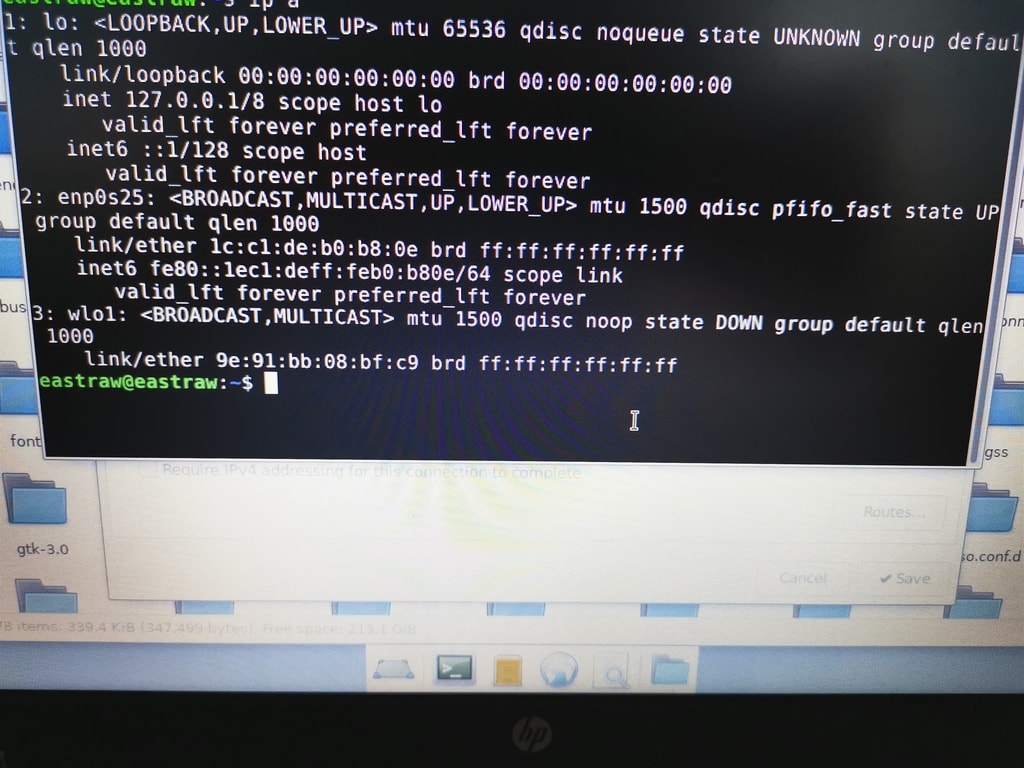

You cannot see the board because you have not set up a static IP address on the host
to set the board to 10.10.10.10 you move W3 up (and cycle the power)
To set the host address, you launch net manager and set the static IP for enp0s25
when properly set, the ip listing for enp0s25 should be something like:
2: enp0s25: <BROADCAST,MULTICAST,UP,LOWER_UP> mtu 1500 qdisc fq_codel state UP group default qlen 1000
link/ether ec:b1:d7:6c:a2:da brd ff:ff:ff:ff:ff:ff
inet 10.10.10.100/24 brd 10.10.10.255 scope global enp0s25
valid_lft forever preferred_lft forever

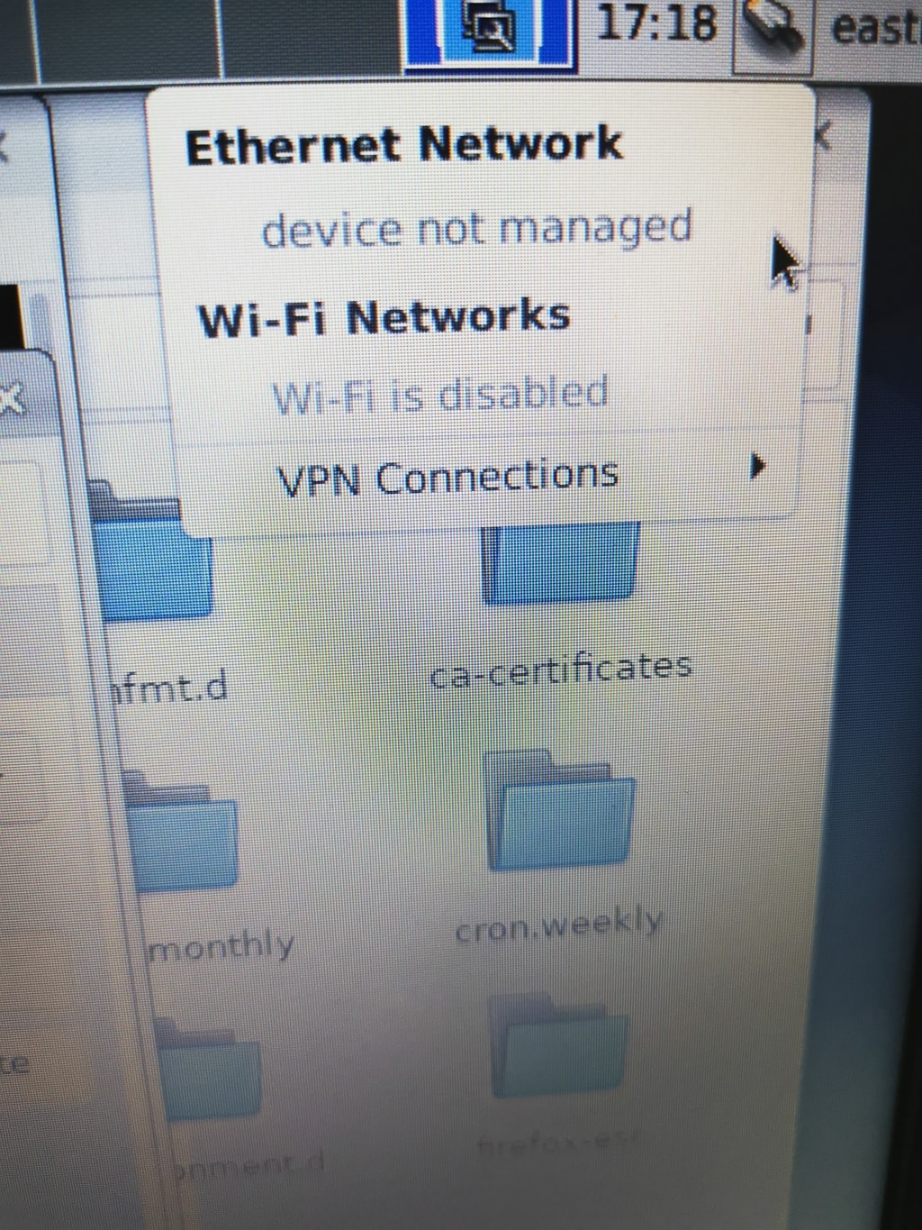

11 Jul 2021 10:59 - 11 Jul 2021 11:00 #214277
by EastRaw
Still have those issues.
What is also weird is that after i did that install as in my message above, my wireless network doesn't works either.
If i right press on the network icon in the top right corner and select edit connections, that list is empty. there are no connections and i'm not able to connect to anything. I can create new connection, but it doesn't seems to work.
Is there a way to revert changes or what can i do in this situation?

Replied by PCW on topic Error message.
You would need to setup your wireless and the real time static IP connections
in network manager. If you cannot edit connections, you need to add new
connections. When you say a new connection does not work do you mean that
the "ip a" report is unchanged? because this is what should be checked to see if the
host interface is properly setup.
It does not look like you ever setup any static IP connection so I don't see what you
would revert there. If WIFI was working with WICD it would need to be setup again
with Network manager.

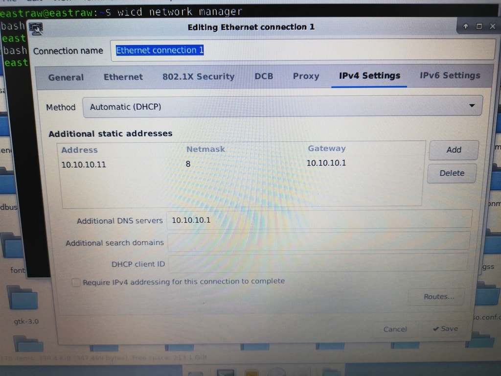

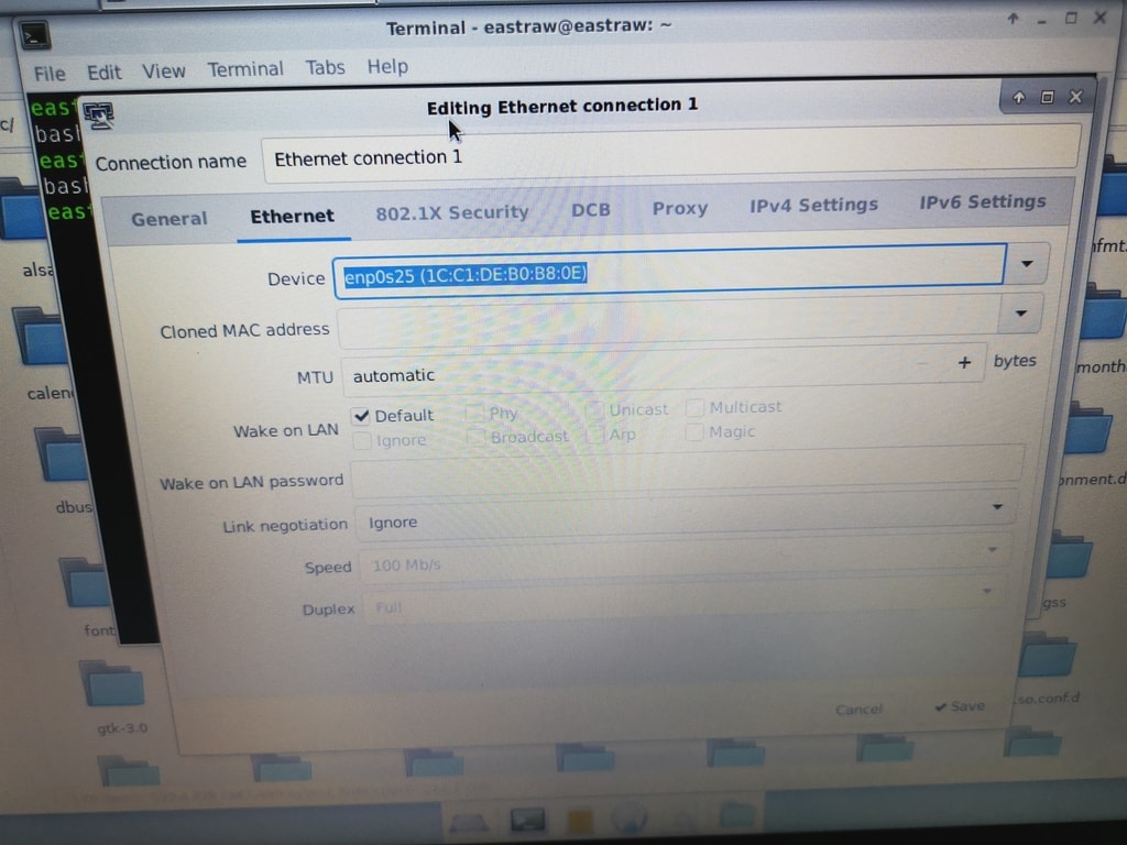

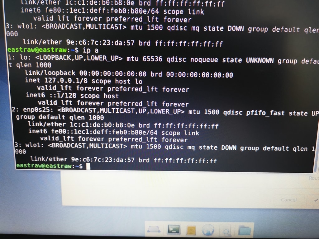

Look, what and how i should set up?
I can't even activate WIFI now.
When i creating ethernet connection i'm entering thing like in screenshot but nothing happens. latest ip a is also attached.
- Posts: 22030
- Thank you received: 7504
11 Jul 2021 12:03 #214287
Replied by tommylight on topic Error message.
In the second picture, set it to Manual, not automatic.

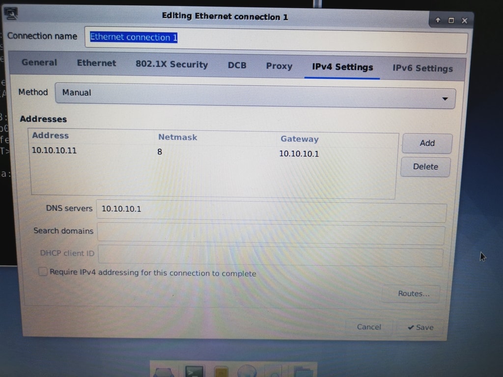

11 Jul 2021 12:10 #214292
by EastRaw
Hi i did, but still the same, nothing happens. No connection to MESA card.
- Posts: 4819
- Thank you received: 2177
11 Jul 2021 12:16 #214294
Replied by Aciera on topic Error message.
Doesn't look like your static IP got set up.
Can you show us the current "IP v4 Settings" page again?
- EastRaw
- Posts: 31
11 Jul 2021 12:45 #214301
by EastRaw
Hi there,
Thanks.
This is the latest. It feels like i'm missing something... Dunno like something is switched off...
It just not working. Feels like i have to un-press some button
Thanks.
