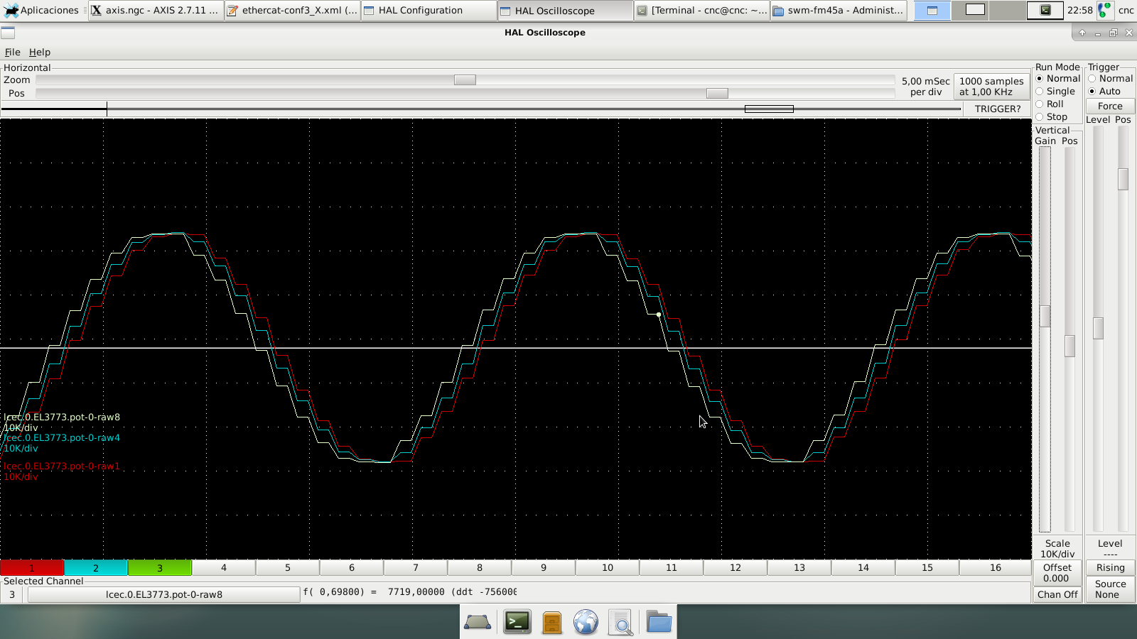

24 Jan 2018 21:06 - 25 Jan 2018 06:14 #104963
by chimeno
Replied by chimeno on topic Ethercat HAL driver
hello Sirop again, I can finally control it in DC mode, this is my configuration:
EL3773
cycle time 1000000
I enable 8 Sudindex = 125000 * 8 sudindex (Samples) = 1000000
sync0Cycle = 125000
sync0Shift = 0
sync1Cycle = sync0Cycle * 7 = 875000 <cycle time
sync1Shift = 0
<master idx = "0" appTimePeriod = "1000000" refClockSyncCycles = "125">
<slave idx = "0" type = "EK1100" name = "EK1100" />
<slave idx = "1" type = "EL3773" name = "EL3773">
<dcConf assignActivate = "730" sync0Cycle = "125000" sync0Shift = "0" sync1Cycle = "875000" sync1Shift = "0 />
</ slave>
I attached the halscope image reading alternating current.
I have a question, reading the manuals would have to be the sync1Cycle = cycle time? Do you know something about it?
Thank you
chimeno

- sirop
- Posts: 193
- Thank you received: 57
26 Jan 2018 13:52 #105038
by sirop
Replied by sirop on topic Ethercat HAL driver
Sorry for a late answer.
As I said somewhere above, I would only experiment with cycle0Shift.
I never used sync1Cycle .
Maybe, lectoraatmechatronica.wikispaces.com/fil...AT+communication.pdf P. 83 can help you.
