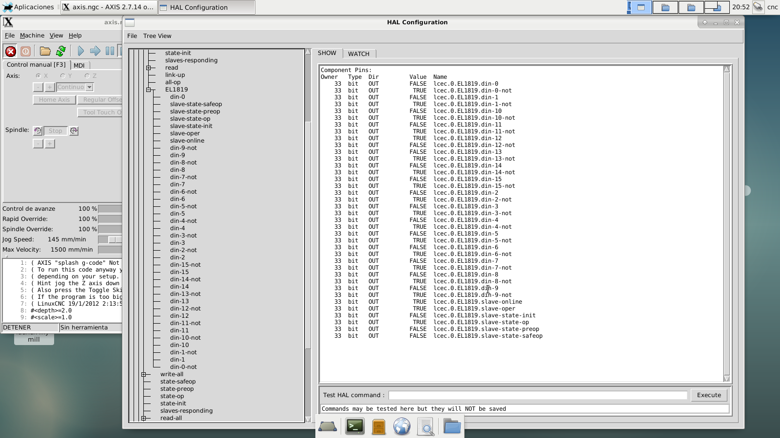

Hi guys,
added the module EL1819 to the standard configuration, greetings Chimeno

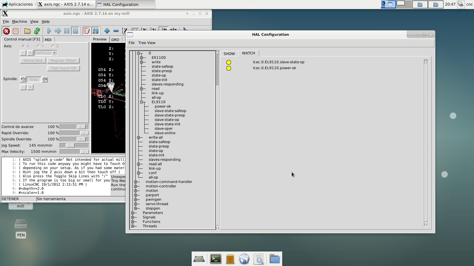

Hi guys,
added the module EL9110 to the standard configuration, greetings Chimeno
