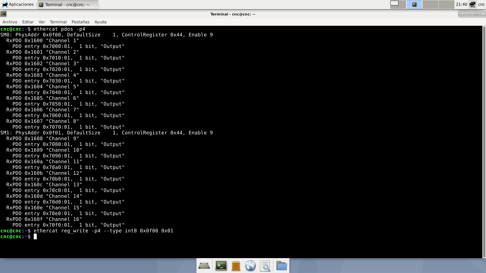

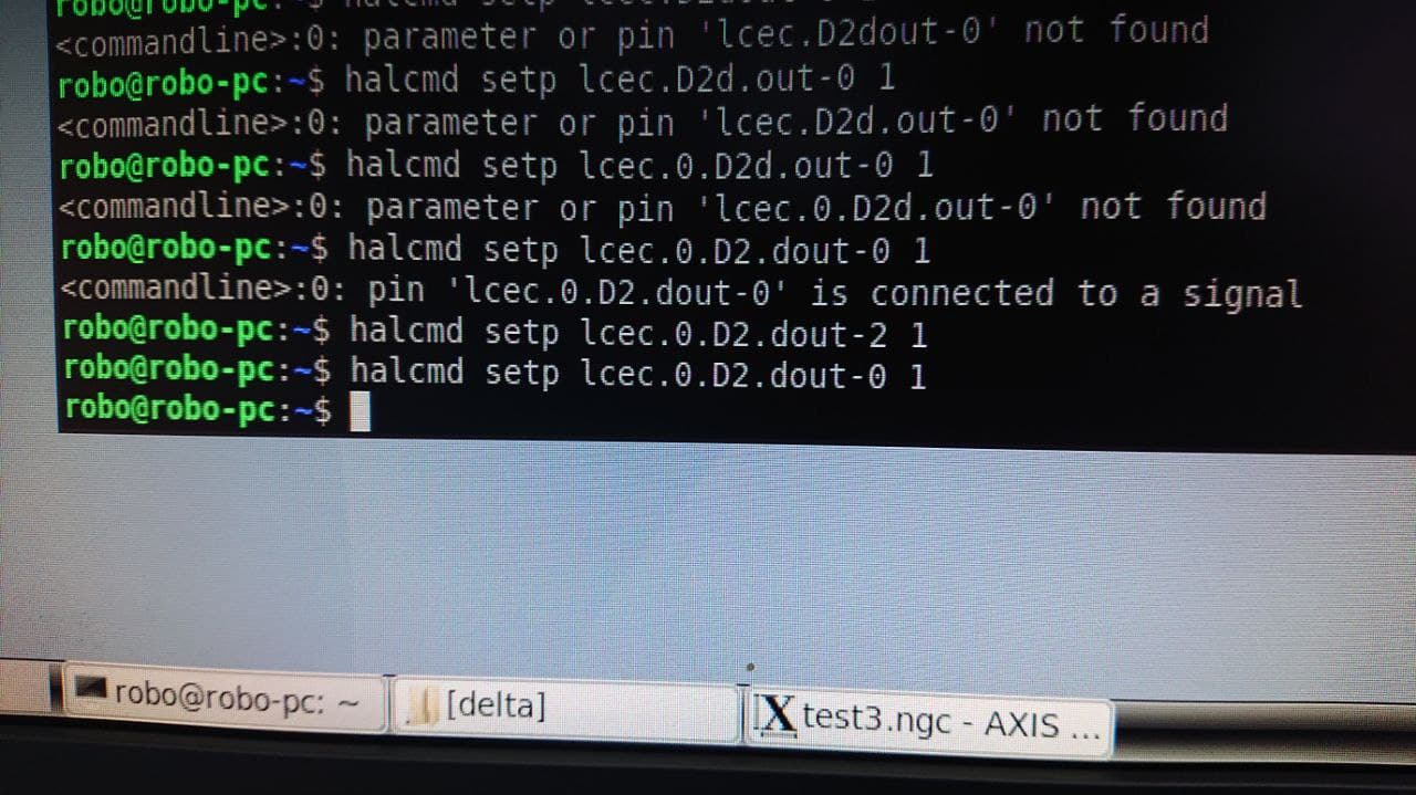

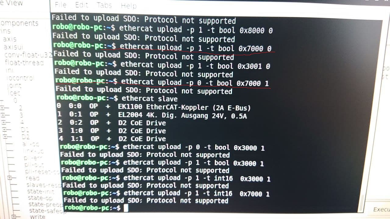

A very dumb question
How I can to send command to el2004 from terminal?
Ethercat download -p (0/1) -t bool 0x7000 1 1 isn't work?
Upd. I do this by "halcmd lcec.0.D2.dout-0 1" But how to send it by simple terminal?

Hello @TheRoslyak
It is trying to send an SDO configuration value to a PDO, I think it is not possible, but it can send a pulse to the register that will be reflected in the output an instant.registry valuevalue
Greeting
Chimeno
ethercat reg_write -p4 --type int8 0xf00 0x010xf000x01Greeting
Chimeno
