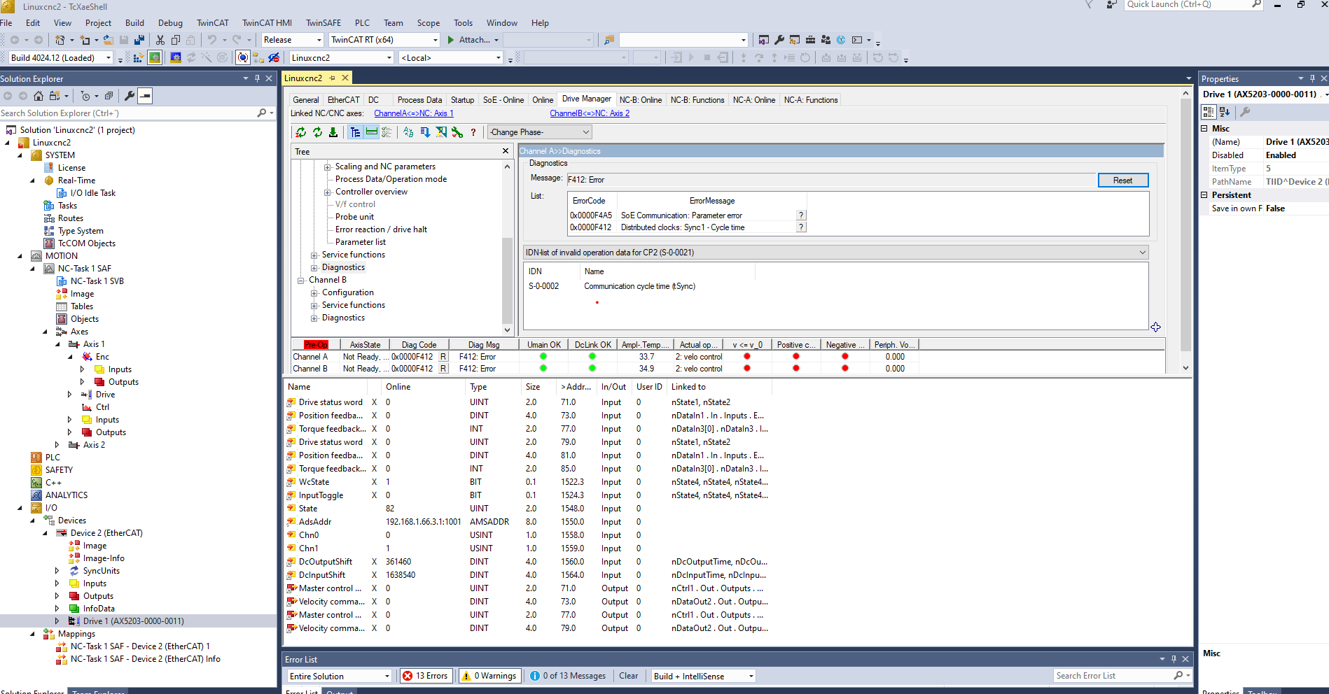

I have attached two dmesg files, the one which ends by db_xml is your xml (Changing only the voltage settings), the other is my real configuration. Both open Linuxcnc (RIP) and give this error:
"Lcec: unable to sync master 0 cycle to reference clock, RTAPI_TASK_PLL_SUPPORT not present"
With the one which ends by DB_xml , the drive goes to OP , nevertheless with mi configuration the drive goes to F4A5 (I haven't been able to run the driver with TWINCAT 3 with tSycc = 1ms Sync1=250us and Sync2=750us (attached screenshot) but curiously with the same configuration and tSync=10ms there is no errors).
im shure this depends on the task setting of the NC TASK in twincat. I've calculated the values for your linuxcnc servoperiod of 1ms. If you create an new config in Twincat(2) task times are default set to 2ms and 10ms. SAF/SVB/IO
