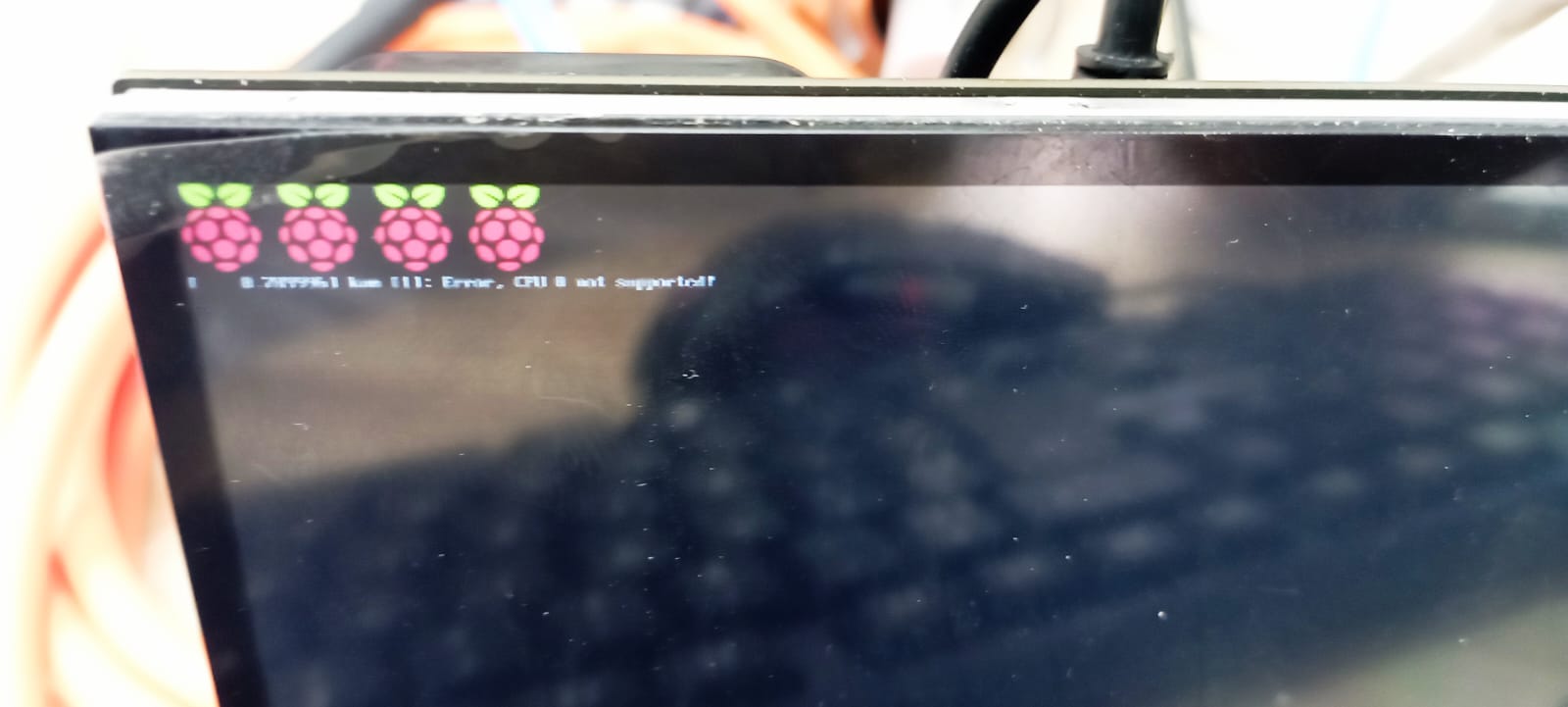

hellow sr. hakan.
Congratulations on your post. I had an initial problem.
I downloaded the image and used the raspberrypi image to save it and it didn't start. Mine is a raspberrypi4b.
O erro "CPU 0 not supported"

At a guess, the image you have used is 32 bit and the Pi4b is 64 bit

I try install but error hardware "cpu no supported" but my cpu is a raspberrypi4 b... what's going on with this?

I verifid the image download and is corrupt. Downlad a twice but result is same. You have other image?

I am using the image from the link that started the forum about ethercat. My raspberry has 8 gigabytes and a 64 gigabyte SD card... and I use the raspberry image to generate the boot. I downloaded this file from the link you sent me now and the error is the same. If I try to open the image, it says that the file is corrupted.

the micro SD is very fragile, nothing is enough and it is no longer usable,
the installation with Raspberry Image is successful but the system does not start, I burned three,
with the installation directly on NVMe M2 and adapter
in my case, I solved it, I do not know if the problem is the same
I reinstalled several times without problems
