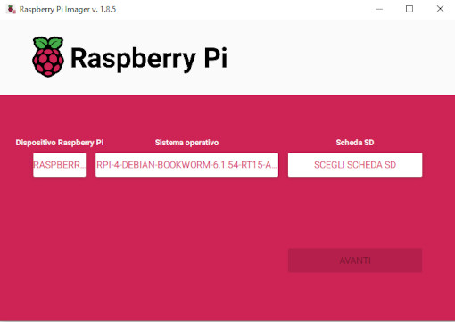

Replied by bertoldo on topic Notes from installation of ethercat on Raspberry Pi 4
Thanks for the answer.
but the issue I see and that makes me suspicious is that I download the image on a PC with W10 and I can't open it. It says it's corrupted, I can't even open it.

I did a test:
I downloaded the image from here with W10
I opened it with Raspberry Image
it loads without problems
Replied by jjdege on topic Notes from installation of ethercat on Raspberry Pi 4
HiThanks for the answer.
I did a test:

09 Sep 2024 17:03 #309759
by bertoldo
Good afternoon jjdege, it loads there... but try to open or mount this image on your computer and you will see that it says it is corrupted. This process with raspberry image loads on the card without errors but when executing it gives errors. There is a problem with this image.

09 Sep 2024 20:59 #309787
Replied by rodw on topic Notes from installation of ethercat on Raspberry Pi 4
The 2.92 image required use of balena etcher to burn it
It looks like the release manager has not released the 2.9.3 Image I gave them. Try this one
drive.google.com/file/d/1Fg2CPTezUyrRFrO.../view?usp=drive_link

09 Sep 2024 21:35 #309790
That 4 year old tutorial is obsolete. It does not use the current version of linuxcnc and ethercat has changed many many times since. There are much easier ways today.
1. Download my 2.9.3 image I linked as it includes the ethercat repository already installed
2. Follow these steps forum.linuxcnc.org/ethercat/45336-etherc...-how-to-step-by-step
