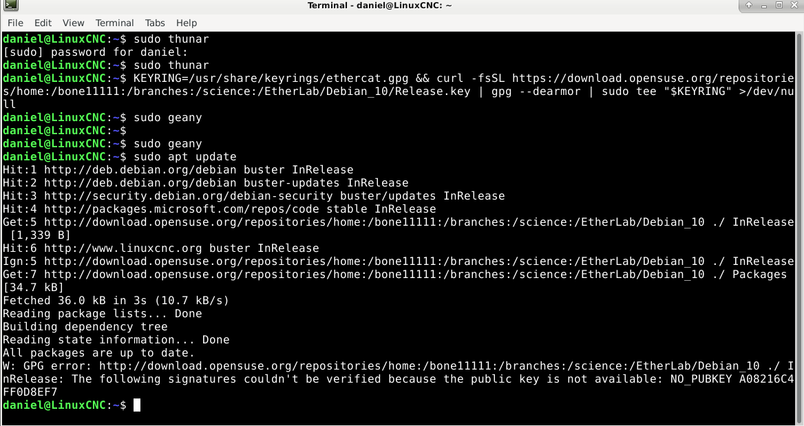

Actual error
I've added the line to the sources.list file and the ethercat.gpg file is there after the KEYRING commands. Not sure what is going on... never failed at this point before.
GPG error: https://download.opensuse.org/repositories/home:/bone11111:/branches:/science:/EtherLab/Debian_10 ./ InRelease: The following signatures couldn't be verified because the public key is not available: NO_PUBKEY A08216C4FF0D8EF7
W: The repository 'https://download.opensuse.org/repositories/home:/bone11111:/branches:/science:/EtherLab/Debian_10 ./ InRelease' is not signed.
N: Data from such a repository can't be authenticated and is therefore potentially dangerous to use.I've added the line to the sources.list file and the ethercat.gpg file is there after the KEYRING commands. Not sure what is going on... never failed at this point before.

Dan, some things may have changed with the security
Follow the instructions here (click on show more)
build.opensuse.org/project/show/home:bon...hes:science:EtherLaband in sources.listOriginally, the instructions here did not give me a good key and I bumbled through
sudo apt update was generating a warning today, now its not.
Still waiting to see if it will install on my chromebook...
KEYRING=/usr/share/keyrings/ethercat.gpg && curl -fsSL https://download.opensuse.org/repositories/home:/bone11111:/branches:/science:/EtherLab/Debian_10/Release.key | gpg --dearmor | sudo tee "$KEYRING" >/dev/null
deb [trusted=yes] http://download.opensuse.org/repositories/home:/bone11111:/branches:/science:/EtherLab/Debian_10/ ./sudo apt update was generating a warning today, now its not.

Yes, the ethercat packages install without error so it should be fine to follow my last post. Let us know how you get on and I'll try and updat the first post

Well, now I am really confused. I have tried to follow those instructions several times.
Step 1) create an empty file in /etc/apt/sources.list.d
STEP 2)copy and paste the keyringdeb [trusted=yes] download.opensuse.org/repositories/home:.../EtherLab/Debian_10/ ./[/code]
spits out
Step 3) Add this line to the etherlab.list file in /etc/apt/sources.list.dsudo apt updatespits out

I saw the W; on the GPG error so decided it was just a warning and pressed on. It seemed to work and it crated the ethercat drivers ec_* in the right folder.
But I did dofirst just in case
od@penguin:/usr/share/keyrings$ sudo apt update
Hit:1 https://deb.debian.org/debian bullseye InRelease
Hit:2 https://deb.debian.org/debian bullseye-updates InRelease
Hit:3 https://deb.debian.org/debian-security bullseye-security InRelease
Ign:4 https://storage.googleapis.com/cros-packages/108 bullseye InRelease
Hit:5 https://storage.googleapis.com/cros-packages/108 bullseye Release
Get:6 http://download.opensuse.org/repositories/home:/bone11111:/branches:/science:/EtherLab/Debian_10 ./ InRelease [1,339 B]
Ign:6 http://download.opensuse.org/repositories/home:/bone11111:/branches:/science:/EtherLab/Debian_10 ./ InRelease
Fetched 1,339 B in 1s (946 B/s)
Reading package lists... Done
Building dependency tree... Done
Reading state information... Done
48 packages can be upgraded. Run 'apt list --upgradable' to see them.
W: GPG error: http://download.opensuse.org/repositories/home:/bone11111:/branches:/science:/EtherLab/Debian_10 ./ InRelease: The following signatures were invalid: B1C282D9C181FD2DC684D6A1A08216C4FF0D8EF7I saw the W; on the GPG error so decided it was just a warning and pressed on. It seemed to work and it crated the ethercat drivers ec_* in the right folder.
But I did do
sudo rm ethercat.gpgPlease Log in or Create an account to join the conversation.

I've got things sorted out. I hate to admit but I think I must have copied the install line along with ip a (find the MAC address) DUH!
The only edit to the instructions I would suggest is to add cd linuxcnc-ethercat before running the make, make clean commands. Other than that flawless. Well done!
