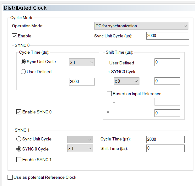

22 Nov 2022 21:59 #257385
by endian
Replied by endian on topic Ethercat installation from repositories - how to step by step
Hello folks,
can anybody make me clear what means this distributed clock row in .xml config file means please? for example ...
I am searching more information because I want to tune up DC config by picture in the attachments. All that I know that DC should be placed before any first slave which has DC option in the .xml file.
Which value should be in assignActivate = ??? please?
Thanks foxington
<dcConf assignActivate="300" sync0Cycle="*1" sync0Shift="0"/>I am searching more information because I want to tune up DC config by picture in the attachments. All that I know that DC should be placed before any first slave which has DC option in the .xml file.
