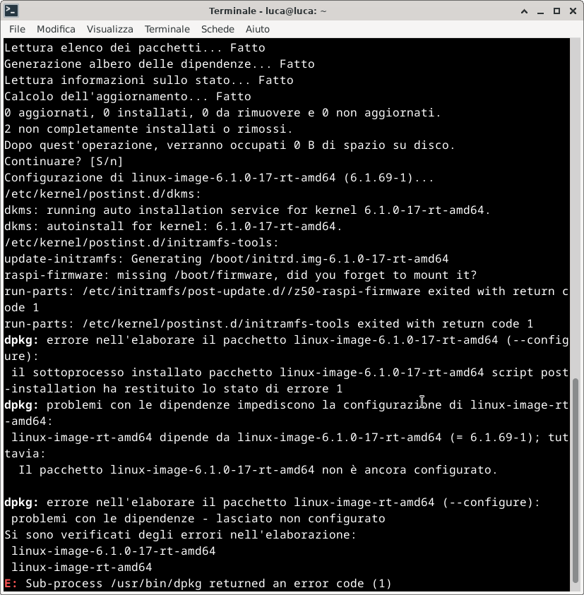

Hi rodw
congratulations for the magnificent work!
I wanted to point out something strangeI installed the ISO linuxcnc.org/downloads/ after the first upgrade, I get this error:
repeated the installation three times but nothing changes.
This does not affect the installation of the EtherCAT repositories
but it persists
I tried with a standard installation
with Iso Debian Bookworm and everything works fine
thank you so much
but it persists
thank you so much

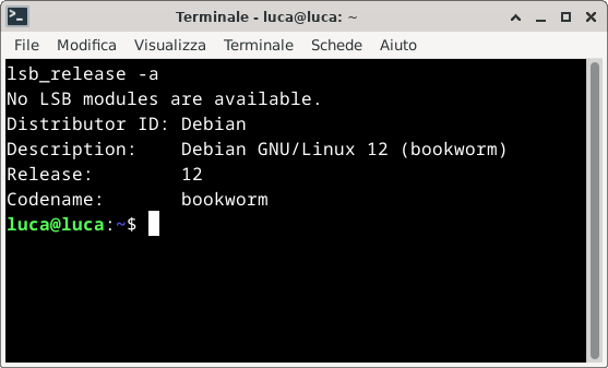

Can you please post the result of
lsb_release -a
Thank you.
To fix the update issue:
forum.linuxcnc.org/9-installing-linuxcnc...-update-error#289920
But do read also the post below as there is a typo on that post.
lsb_release -a
Thank you.

04 Feb 2024 15:17 - 04 Feb 2024 15:20 #292406
by jjdege
Replied by jjdege on topic Ethercat installation from repositories - how to step by step
wow!!! thanks I solved it
this is the result of
lsb_release -a
Thank you very much
lsb_release -a
Thank you very much

@jjdege
This does not appear to be anything to worry about. The RT kernel errors on an update to the net version but all other packages seem to get installed.
I replicated this yesterday as it was reported by another user.
@everybody, please don't raise issues on this thread that are not related to ethercat installation. Add another thread in the appropriate forum section.
