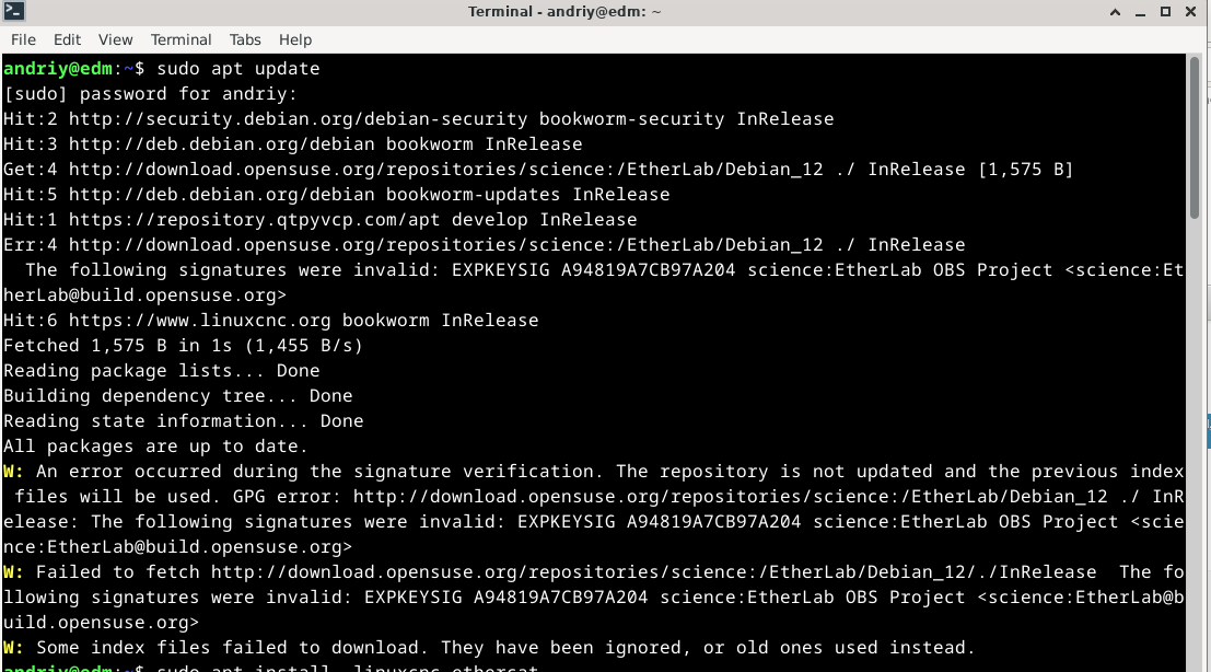

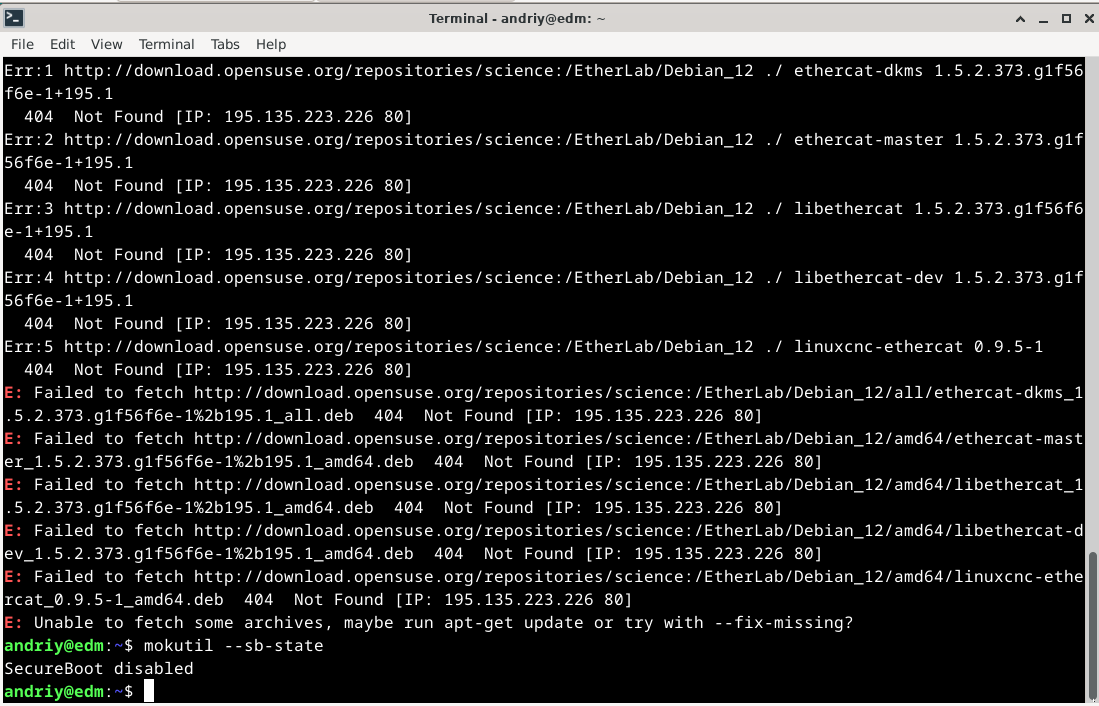

28 Jul 2024 13:53 - 28 Jul 2024 13:57 #306237 by AndriySM
   good morning, I'm new to linuxcnc, I tried following all the steps described in the guide but I can't install ethercat on linuxcnc, I always get the same errorWhat could it be that it can't find the necessary files. Where am I wrong

28 Jul 2024 14:15 #306238 by tommylight
1. Does the PC have an internet connection?
2. Do in a terminal " sudo apt update " before trying to install
28 Jul 2024 16:20 #306245 by AndriySM
Yes, the PC has an internet connection, running the sudo apt update command, which I did before, gives me this error

28 Jul 2024 17:18 #306248 by rodw
There appears to be something broken at ethercat themselves.

28 Jul 2024 18:14 #306255 by rodw
I have raised an issue with them
gitlab.com/etherlab.org/ethercat/-/issues/131
