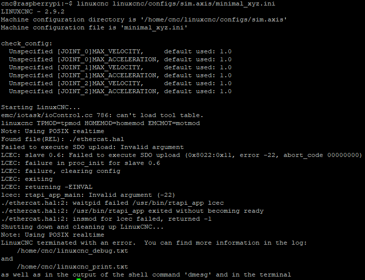

- Mehta_123
- Posts: 18
16 Apr 2024 06:50 - 16 Apr 2024 07:07 #298341
by Mehta_123
Replied by Mehta_123 on topic Ethercat installation from repositories - how to step by step
Hello !!Thanks for the detailed steps, I have installed ethercat and able to detect slaves. As I am totally new to this I am not able to start LCNC.I have followed steps of xml and hal file from youtube (attaching hal file and error for your reference)
I am aware that its the issue of xml file as I am using different driver (panasonic MBDLN25BE)
Can you please guide me what type of changes I need to do in xml file ?
Thanks and Regards,
Mehta
Thanks and Regards,
Mehta

- sevketsakinc
- Posts: 2
19 May 2024 17:12 #300972
by sevketsakinc
Replied by sevketsakinc on topic Ethercat installation from repositories - how to step by step
Hello, first of all, thank you for your descriptive shares.
I used a servo with ethercat using "Debian 9" 4 years ago and it has been working since then.
PC: INTEL 9TH GENERATION I3
Ethercat version is 1.5.2.
Servo: Panasonic A6
Now I wanted to use Debian 12, Ethercat version 1.6.0 and LinuxCNC 2.9.2, which has been updated according to your shares.
PC: INTEL 12th GENERATION i3
When I close the Linuxcnc interface, the servos get a synchronization error. This did not happen in the old version.
The servo is still the same servo (PANASONIC A6) but I was getting 80.4 synchronization error.
This error ( <dcConf assignActivate="300" sync0Cycle="*1" sync0Shift="0"/>
<watchdog divider="2498" intervals="5000"/>
I solved it by doing .
But now, when I restart it, some of the servos do not switch to OP mode on the first try.
Can you help me ?
I am grateful.

- RiJa
- Posts: 11
02 Jul 2024 08:04 - 09 Jul 2024 12:28 #304209
by RiJa
Replied by RiJa on topic Ethercat installation from repositories - how to step by step
Last edit: 09 Jul 2024 12:28 by RiJa.
- Posts: 12125
- Thank you received: 4140
02 Jul 2024 09:09 #304215
Replied by rodw on topic Ethercat installation from repositories - how to step by step
I think there is a path issue in line 14 looking for lcec_conf
