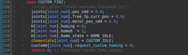

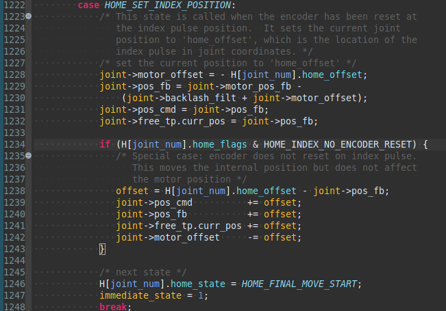

16 Jun 2024 05:56 #303100 by Aciera
It is possible, the offset is not implemented. I'm using Marco Reps modifications with a custom comp file, which is based on standard homing.c
Looking at 'el8_homecomp.c' confirms that 'HOME_OFFSET' is indeed not implemented:
Looking at the default 'motion/homing.c' it may not be all that much work to get it to work:
The following user(s) said Thank You: DPFlex
