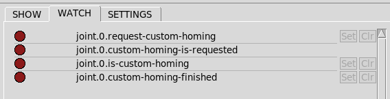

Thanks for the effort putting in this modification! Now I have time to test it.
This is what I do:
Download the file el8_homecomp_mod.com and after giving the path to homing.c compile with halcomp
"sudo halcomp --install el8_homecomp_mod.com"
This went ok without errors.
I changed the Marco's component from the ini to yours:
HOMEMOD=el8_homecomp_mod
Uncommented the drives internal homing in hal on every axis:
net x-home-request joint.0.request-custom-homing => cia402.0.home
net x-homing joint.0.is-custom-homing <= cia402.0.stat-homing
net x-homed joint.0.custom-homing-finished <= cia402.0.stat-homed
run the lcnc, and the hal pins show up:
I set a hal part for toggle the custom home request:
#custom home request
sets joint.0.custom-homing-is-requested true
After that I have errors, this pin not exists. But is there. Whats next?
Thanks!
This is what I do:
Thanks!
- Posts: 4819
- Thank you received: 2177
20 Jun 2024 09:07 #303418
Replied by Aciera on topic Help Needed: Cracking the Code on LinuxCNC Servo Homing Setup!
change this line:
to
Then the pin 'joint.0.request-custom-homing' (the uppermost entry in your 'WATCH' list should give your the options 'Set' , 'Clr' to manually set the pin to true (ie 'Set'))
net x-home-request joint.0.request-custom-homing => cia402.0.hometo
net x-home-request joint.0.custom-homing-is-requested => cia402.0.homeThen the pin 'joint.0.request-custom-homing' (the uppermost entry in your 'WATCH' list should give your the options 'Set' , 'Clr' to manually set the pin to true (ie 'Set'))

20 Jun 2024 09:55 #303422
by eduard
Replied by eduard on topic Help Needed: Cracking the Code on LinuxCNC Servo Homing Setup!
The problem is with: joint.0.custom-homing-is-requested
When I set to true to change the state in hal to toggle custom homing, I have this error:
/home/eduard/linuxcnc/custom/M5_EtherCAT.hal:33: signal 'joint.0.custom-homing-is-requested' not found
this is the toggle in hal:
But I have this hal pin, based on halshow as I attached in prevous post.
- Posts: 4819
20 Jun 2024 10:01 #303424
Use 'setp' instead:
You are using the wrong hal command (sets) here as that is for setting a signal.sets joint.0.custom-homing-is-requested true
Use 'setp' instead:
setp joint.0.custom-homing-is-requested truePlease Log in or Create an account to join the conversation.
- eduard
- Posts: 80
- Thank you received: 12
20 Jun 2024 10:08 #303425
by eduard
Ok, I changed to setp, but the pin is not writebale.
M5_EtherCAT.hal:33: pin 'joint.0.custom-homing-is-requested' is not writable
- Posts: 4819
20 Jun 2024 10:13 - 20 Jun 2024 10:18 #303426
[edit]
We are trying to set the wrong pin
I'm sorry the line should be:
setp joint.0.request-custom-homing true
Last edit: 20 Jun 2024 10:18 by Aciera. Reason: fix wrong command
- eduard
- Posts: 80
20 Jun 2024 10:24 #303427
by eduard
Yepp, I did not see either.
But here is the next error:
HAL: ERROR: signal 'x-home-request' already has output pin
- Posts: 4819
20 Jun 2024 10:27 #303428
Besides this line:do you have another line with 'x-home-request' in your hal?
net x-home-request joint.0.custom-homing-is-requested => cia402.0.homePlease Log in or Create an account to join the conversation.
- Posts: 4819
20 Jun 2024 10:40 #303429
Ok, it seems that 'cia402.0.home' is of type 'IO' not 'IN' so I changed the custom homing comp to make 'joint.0.custom-homing-is-requested' have type 'IO'. Not sure if this works but give it a go:
Don't forget to halcompile --install the new comp.
