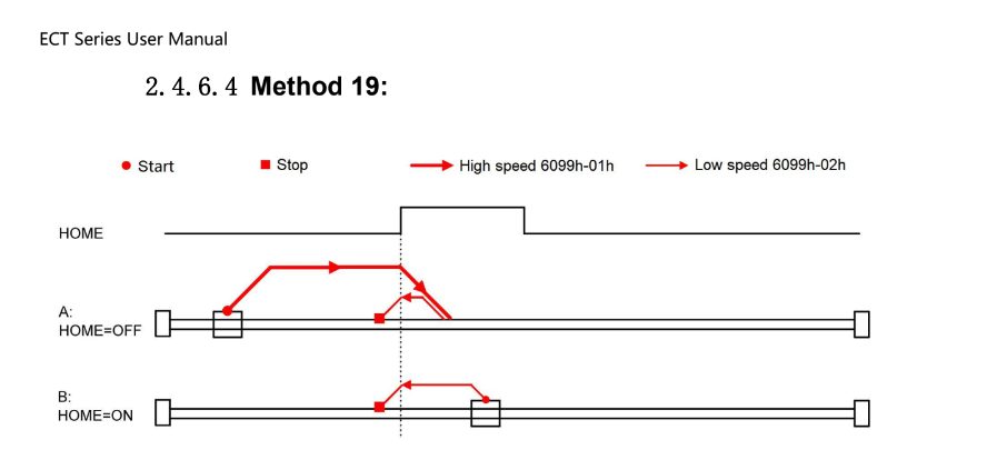

16 Jun 2024 06:42 #303101 by rodw
Yes, onceinternal homing is used, most additional features are obseleted.
Home offset is probably supported by your servo's homing methods.
Marcoreps uses a CIA402 compatible drive and the standard offers many homing types.
This one looks like  a home offset to me.
Check your documentation for your drive.

16 Jun 2024 08:33 - 16 Jun 2024 08:38 #303108 by eduard
Looking at the default 'motion/homing.c' it may not be all that much work to get it to work:
It would be nice to use most of the lcnc features where is not absolutely necessary to use the servo internal features. But implementing the home offset is out of my knowledge. And the soft limit as well.

16 Jun 2024 08:36 - 16 Jun 2024 08:38 #303109 by eduard
This is the exact method what I'm using now to home the drives. Starting with high velocity to search the limit switch, when found turn the direction with low speed and looking for encoder Z signal. Then stops. And send homed to lcnc.
If I'm using the internal offsets, I'll miss the opportunity to use lcnc softlimits, which is important. (If I'm right. Not sure.)

16 Jun 2024 11:07 #303115 by Aciera
If you want you could give the modified component in the attached folder a try.
halcompile the component el8_homecomp_mod
and then change the name in your ini fromHOMEMOD=el8_homecomp
to
HOMEMOD=el8_homecomp_mod
The modified component compiles on my system but I cannot test anything due to a lack of hardware.
Note this assumes that 'cia402.0.pos-fb' is reset to zero by the homing procedure, if that is not the case we could try the other option used in homing.c, so please check if that pin is reset to zero or not.

16 Jun 2024 14:32 #303122 by rodw
First there was cia402.comp
Then came custom homing.
marcoreps forked the cia402.comp from here
github.com/dbraun1981/hal-cia402
It definitely switches to homing mode but it was developed on a drive that homed to index
But it never worked with cia402 external switches. I ried very hard before concluding changes to homing.c were required, then the homecomp was released.
I have also worked on a cia402 homecomp and was hoping it would become part of the ethercat repository in time and the need for cia402.comp would be obsoleted.
github.com/rodw-au/cia402_homecomp
