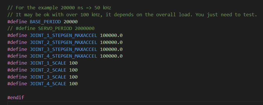

18 Feb 2025 19:16 #321934
by COFHAL
Replied by COFHAL on topic MAX VELOCITY STEP.
In the firmware the stepgen scale JOINT_1_SCALE is defined at 100. I put that value in STEP_SCALE in the ini file and the speed is no longer limited nor does it give me a following error. I don't know if I'm wrong but the value of STEP_SCALE in the ini file is determined by the value programmed in StepGen3.h. Or I don't understand what the value JOINT_X_SCALE refers to.
- Hakan
- Posts: 1317
- Thank you received: 454
18 Feb 2025 19:50 #321938
by Hakan
Replied by Hakan on topic MAX VELOCITY STEP.
Yes. yes. yes. hmmm.
Yeah I think you are right, those JOINT_1_SCALE should be brought out as a pdos, not be a firmware constant.
Should of course not be a constant haha. My mistake there. From development and testing. Set them to what you found worked.
The SCALE and also MAX_ACCELERATION variables should be brought of from the firmware to hal or as a sdos in ethercat-config.xml.
I need to work on that, haven't been able to make writable sdos yet. Readable is ok. I think it is some minor thing, but takes time to find it.
Can also be pdos.
So if you can make the changes you need then I will come back on this topic in a week or two. To see where you are and what changes you have made, and update the firmware on github with for example the scale and max_acceleration parameters.
Can also be pdos.
