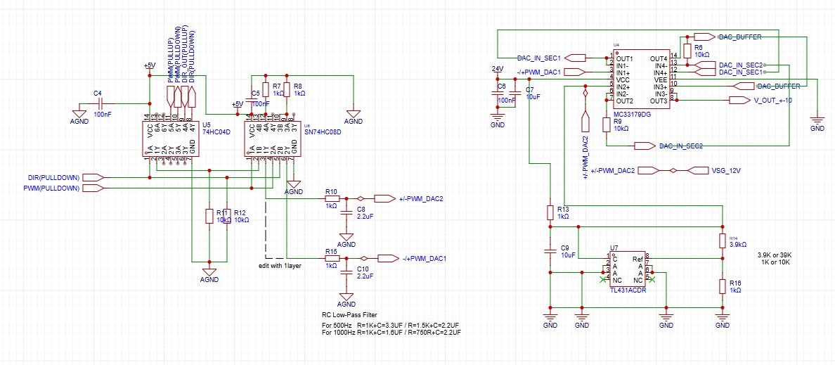

Earlier in the thread there is an attachment with spindle control schematics, maybe you already had a look on that one.
My spindles are all controlled via Modbus/VFD and the 3V analog output was put there for good measure.

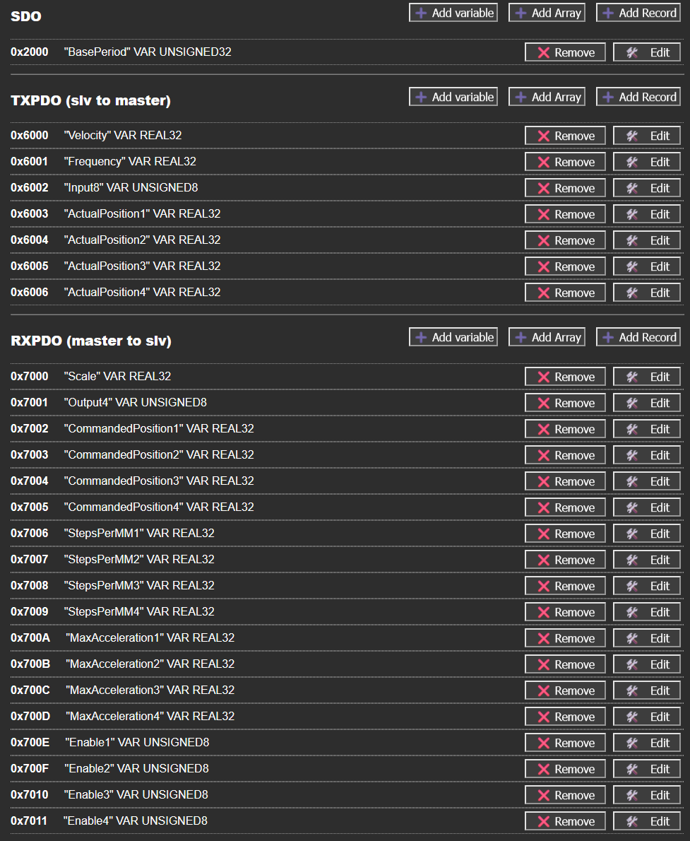

I see that I've updated the information related to the AX5800 card. Now I have some questions:
I see that I created some enable pins. I assume they are to enable the output of each of the step generators. In the XML file for LINUXCNC, these pins appear as BIT, but I don't know how to configure them correctly in the EEPROM generator file. Bit variables don't appear there. In that same file it appears
<pdoEntry idx="6001" subIdx="01" bitLen="32" halPin="Frequency" halType="float-ieee"/>

I think there is something not quite right in the eeprom_generator with bits, so I use uint8 instead.
And then create a bit pin in linuxcnc with
<pdoEntry idx="600x" subIdx="01" bitLen="8" halPin="enable1" halType="bit"/>
Those DI pins are the input pins, for switches etc. I think the halType should be "bit" for them.
What do you do in the code with the enable information?

I see that the EaserCAT-3000 board firmware has been updated on Github. As you mentioned earlier, you left out the step scale so it could be modified from the INI file. You also added enable pins, but I don't know how to use them. Could you explain these changes a little more?

I answered on the github issue tracker, but you set number of steps with normal "setp" in the hal file.
The new Enable PDO/Pin should be connected to net x-enable, that way it only generates steps when the machine is "on".
Like soYou also have MaxAcceleration as a new PDO and the guideline is some 25% higher than ACCELERATION in the ini file.
Like so
setp lcec.0.E3000.StepsPerMM1 200
net x.enable lcec.0.E3000.Enable1

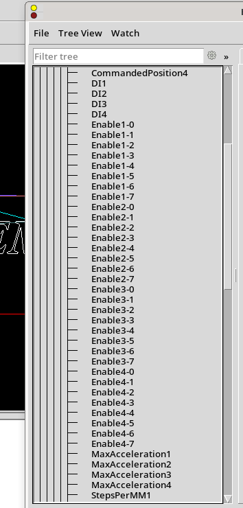

The CAT3000 definitely doesn't work with Linuxcnc with the latest version. If I connect it to TwinCAT, there's no problem. I can go to OP state, the inputs and outputs work, the encoder too, but with LNC, nothing works; it doesn't go to OP state. Something very strange is that many Enable pins are generated, 8 in total for each Enable, as seen in the photo. I don't know if the problem could be the ethercat-conf file.
