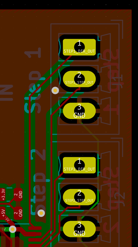

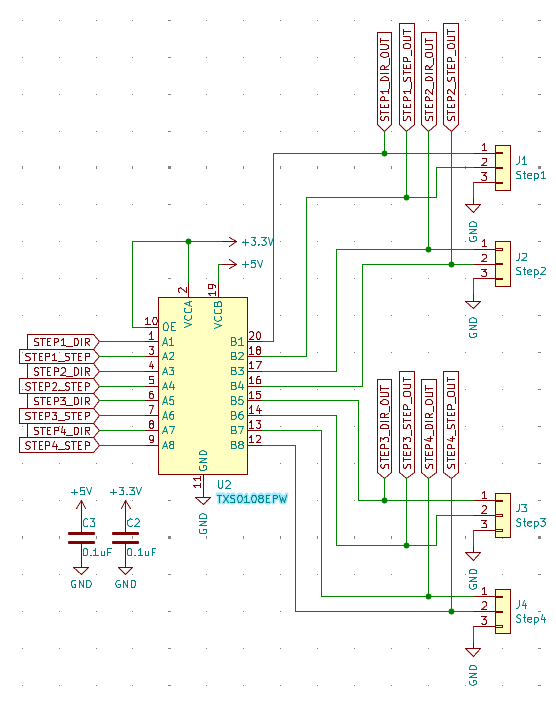

14 Dec 2024 10:00 #316655 by COFHAL
Replied by COFHAL on topic Commun pin drivers
I have a question about how to connect the STEP DIR motor control outputs. Since they are not differential, one of the input pins on the driver is common. Which is common, the negative or the positive of each driver input?
14 Dec 2024 11:53 #316660 by Hakan
Replied by Hakan on topic Commun pin drivers
This is the Kicad schematics
and the Kicad layout of the connector on the board
Common is negative, GND.
