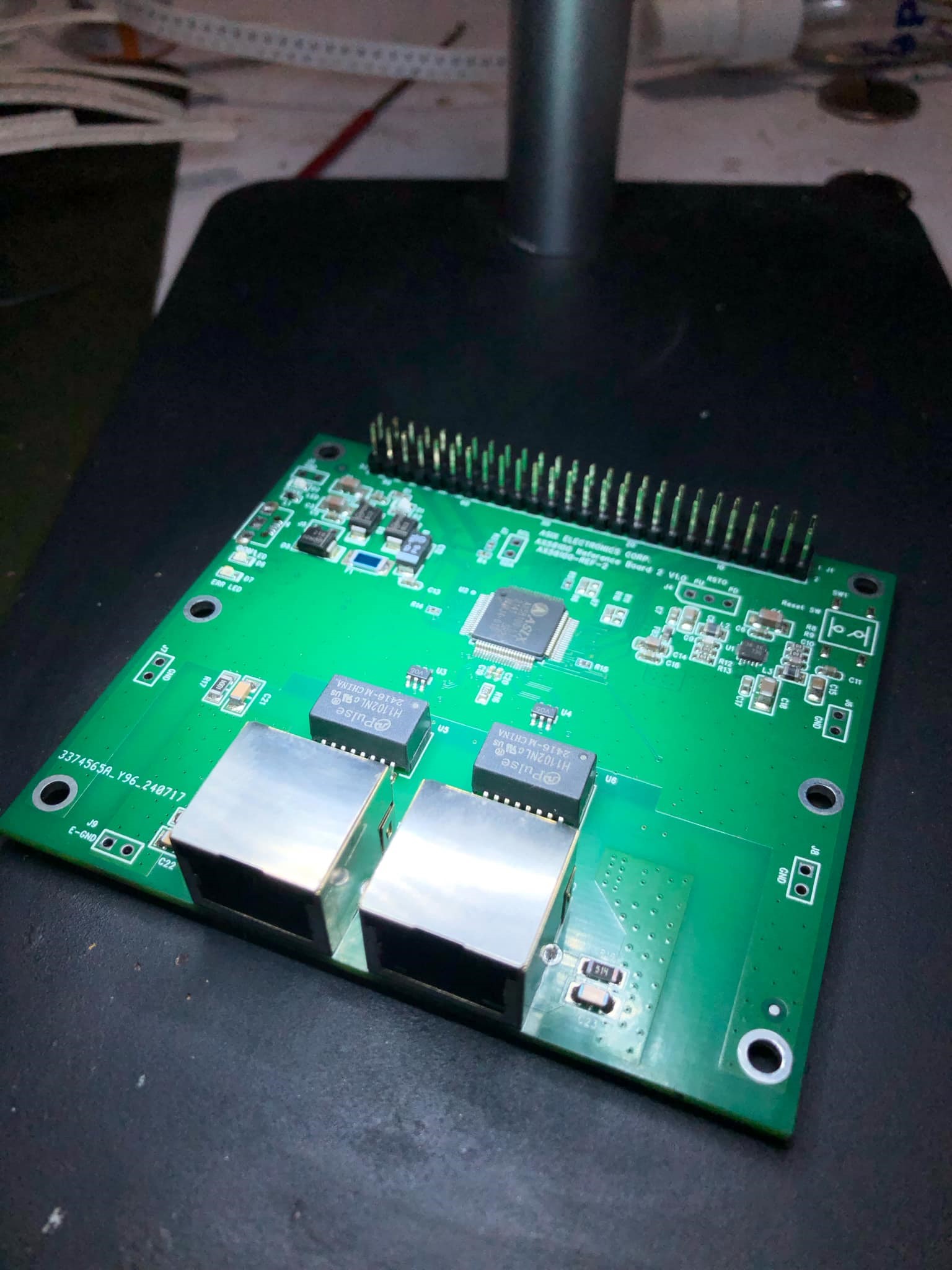

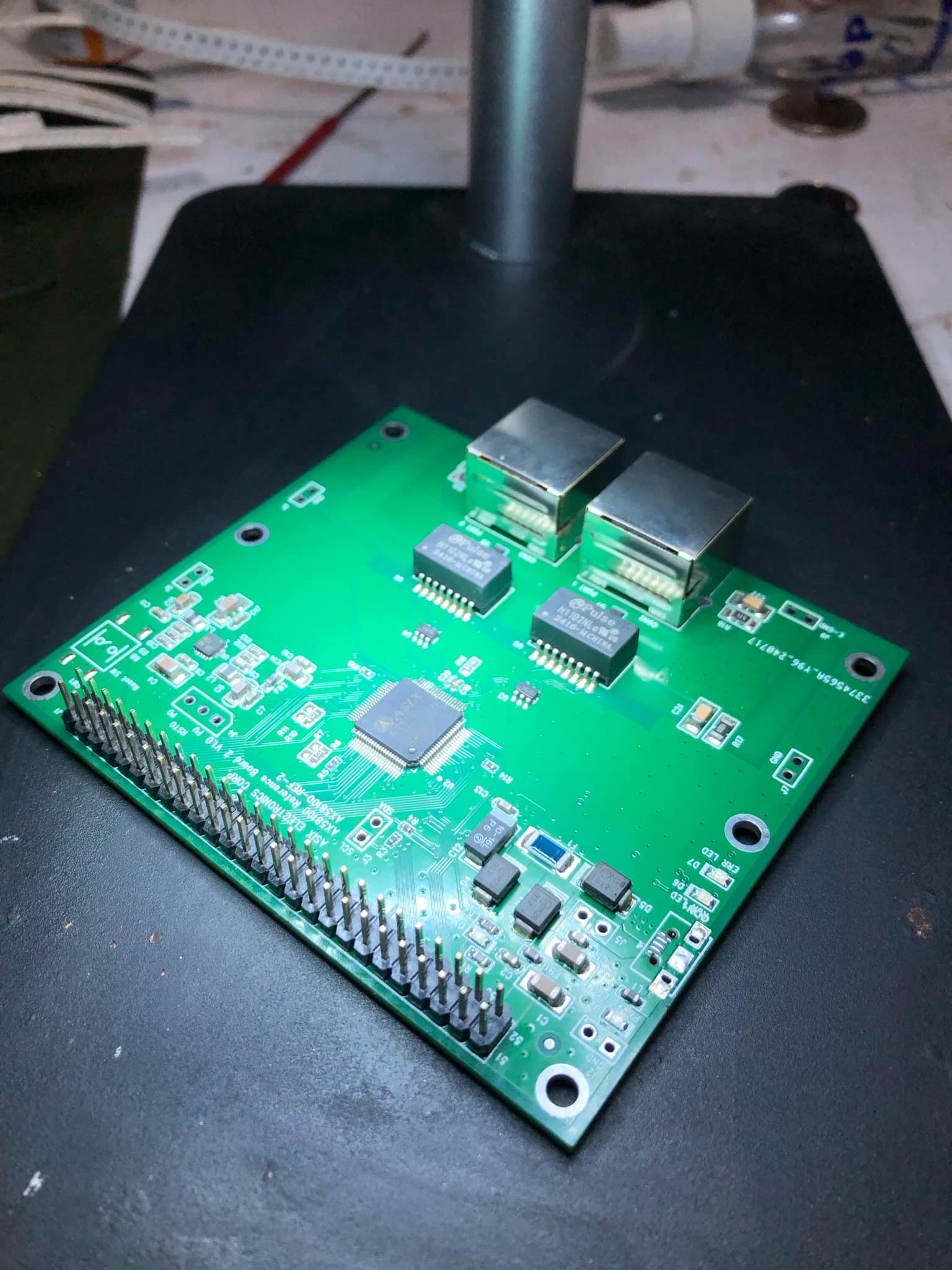

Hello
I'm a newbie. I started DIY Ethercat board with AX58100
1. AX58100-16in-16out
2. AX58100-Step/DIR + Encoder ABZ +8in/8out GPIO
Everything works on Twincat and I can connect it to Linux lcec
I want to use it with Linux CNC as 3axis and 1 spindle
In the axis there are
-Step/Direct
-Input8
-Output8
-Encoder ABZ
And there is AX58100-16in-16out board as the main I/O of the system
But I still can't create the correct ethercat-conf.xml file. I don't understand if it needs to be used as CIA402 or not
I have attached the XML files from AXIS for both boards
Can you please suggest a generator for ethercat-conf.xml for this project
Thanks for your support

I created ethercat-conf.xml used IO 8in-8out successfully.it works.

Yes, it can't process by itself, as the manufacturer replied by email.
I tried step/direct with factory XML via twincat, it works. I'm still new to ethercat, I can't do much more.
