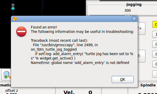

Hallo gmoccapy fans,
I started to use gmoccapy some weeks ago, on my converted Deckel FP1, see also the topic
www.linuxcnc.org/index.php/english/forum...increased-my-latency
All is going very nice, and I like the UI, especially after adding a touch screen to my setup !
I initially ran the "user" version of gmoccapy, v1.3.x with Linux 2.6.5, installed from the ISO and the upgrade.
That works well.
Recently I tried to do a simple upgrade to 1.5.1.1. by getting the sources from git, and copying them to my libraries. According to the instructions in the wiki:
just download
gmoccapy.py
gmoccapy.glade
notification.py
from scr/emc/usr_intf/gmoccapy of git
At git.linuxcnc.org/gitweb?p=linuxcnc.git;a...ntf/gmoccapy;hb=HEAD
2. Then replace the files on your computer, be aware that gmoccapy.py will loose its py. ending
gmoccapy.py goes to /usr/bin as gmoccapy
gmoccapy.glade goes to /usr/share/gmoccapy/
notification.py goes to /usr/share/pyshared//gmoccapy/
And also changing the appropriate permissions, etc.
However when running gmoccapy now, I get a scripting error on the alarm entries, see attachment.
When I change the script on line 2499 to read
if self.log: self._add_alarm_entry( "turtle jog has been set to %s" % widget.get_active() )
the UI works.
I guess I am doing something wrong in the install steps, but not sure what..
Thanks for your help,
Frans
19 Jan 2015 05:53 - 19 Jan 2015 05:55 #55155 by newbynobi
Replied by newbynobi on topic Gmoccapy - A new screen for linuxcnc
You did all correct, my fault!
Thanks for reporting the bug, i will corect tomorow!
Norbert
P.S. to update, best is to use 2.6 buildnot repository!

23 Jan 2015 19:12 #55292 by franstrein
Replied by franstrein on topic Gmoccapy - A new screen for linuxcnc
Norbert,
Thanks for your fast response and creation of gmoccapy 1.5.1.4.
That solved indeed my problem.
