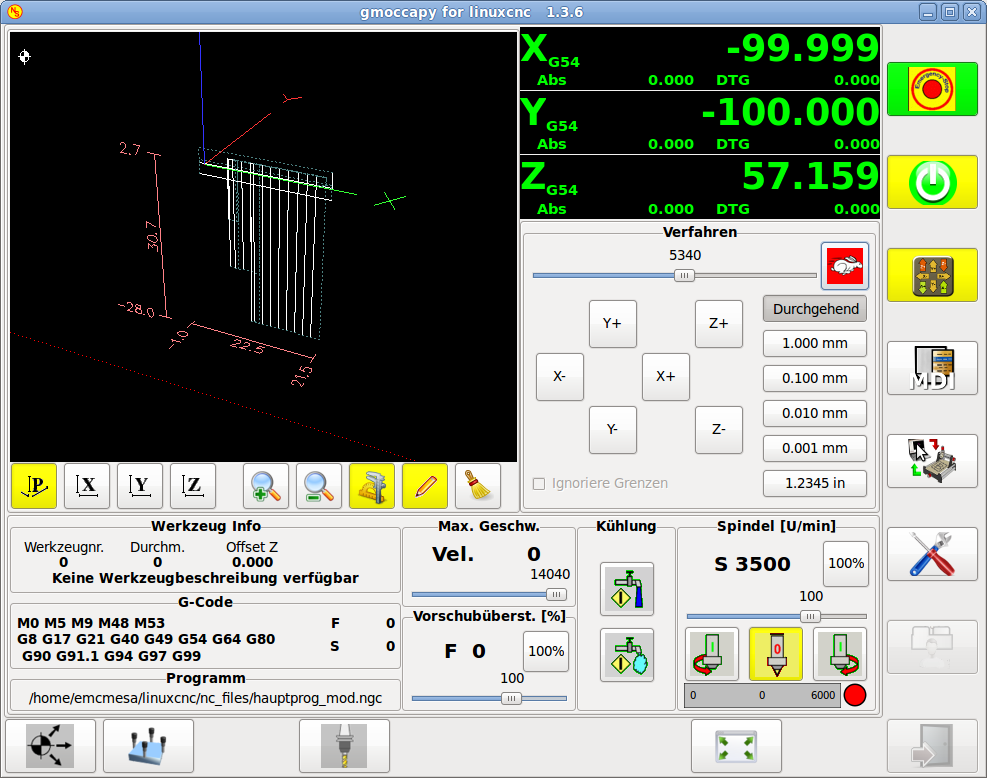

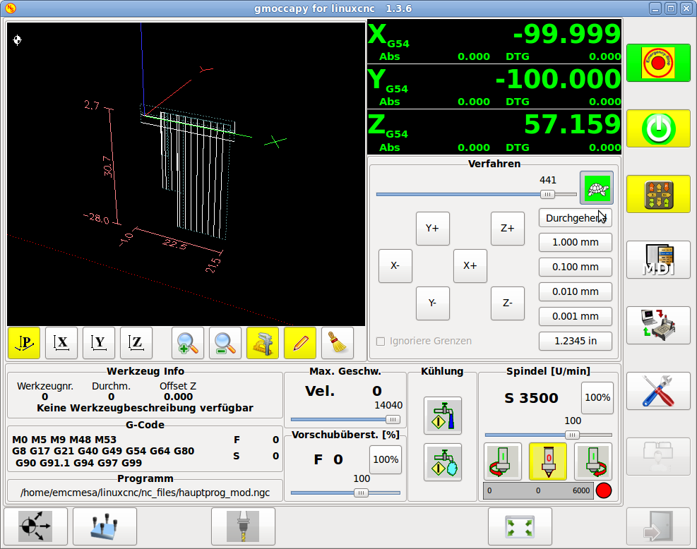

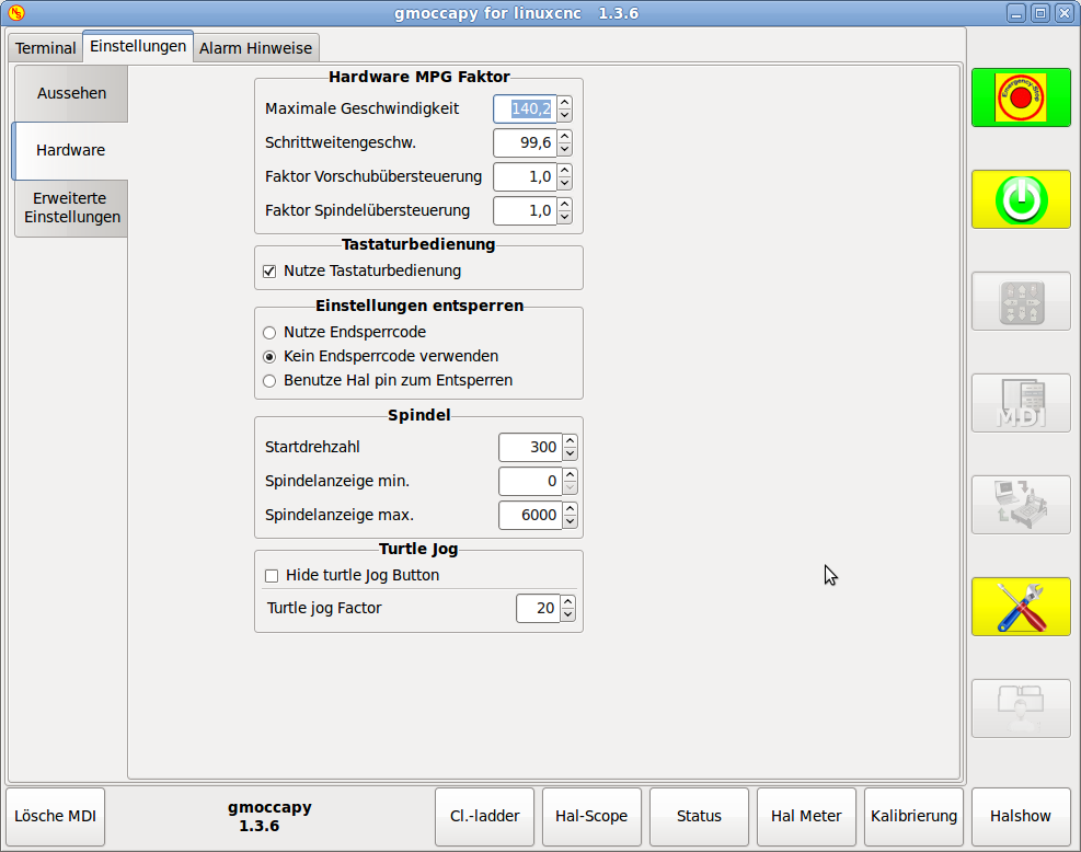

30 Dec 2014 01:51 - 30 Dec 2014 01:54 #54373 by newbynobi
Replied by newbynobi on topic Gmoccapy - A new screen for linuxcnc
@All,
is that the way you do like it?
- turtle max jog vel is Max vel / 20 by default, but can be set according to your needs on the settings page
- If a user do not like the behavior, the turtle button can be hidden on the settings page.
- If you use a Jog Wheel, the scale for jog counts will be applied individually for turtle and rabbit jogging, meaning if you need 100 counts from min to max, you will need the 100 counts if you are in turtle or in rabbit mode.
Did I miss something?
Who likes to test and who does the documentation?
Norbert

30 Dec 2014 03:01 - 30 Dec 2014 03:05 #54376 by DaBit
Replied by DaBit on topic Gmoccapy - A new screen for linuxcnc
No problem testing that button. Let me know where I can find the required files (I'm running a 2.8~pre RIP build so easy to copy files to the right location)
It's pretty much what I would want; I often find myself sliding back the jogspeed to do a bit of manual milling and then using MDI to go back since hitting that slider on a touchscreen is a bit frustrating sometimes.
Documentation should be a paragraph or two at the most? It is not exactly my hobby, but I suppose I could do that.

ver. 1.4.0
- introduced turtle jog, allowing two scales for the jog vel adjustment
- new hal pin "gmoccapy.turtle-jog" to switch from rabbit-jog (fast mode) to turtle-jog (slow mode) using a hardware switch
