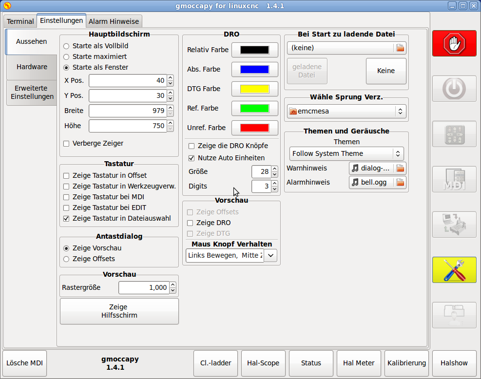

03 Jan 2015 04:44 - 03 Jan 2015 04:47 #54513 by newbynobi
Replied by newbynobi on topic Gmoccapy - A new screen for linuxcnc
gmoccapy 1.4.1
- corrected broken layout style, as the jog-increment buttons has not
been modified to change there background color, getting only dark gray
instead of yellow, if they where active. No the follow the gmoccapy style.
- the number of digits of the DRO can now be set on the settings page, so
users of fragile machines can reduce the digits.
Norbert

04 Jan 2015 01:53 - 04 Jan 2015 19:28 #54526 by newbynobi
gmoccapy documentation
