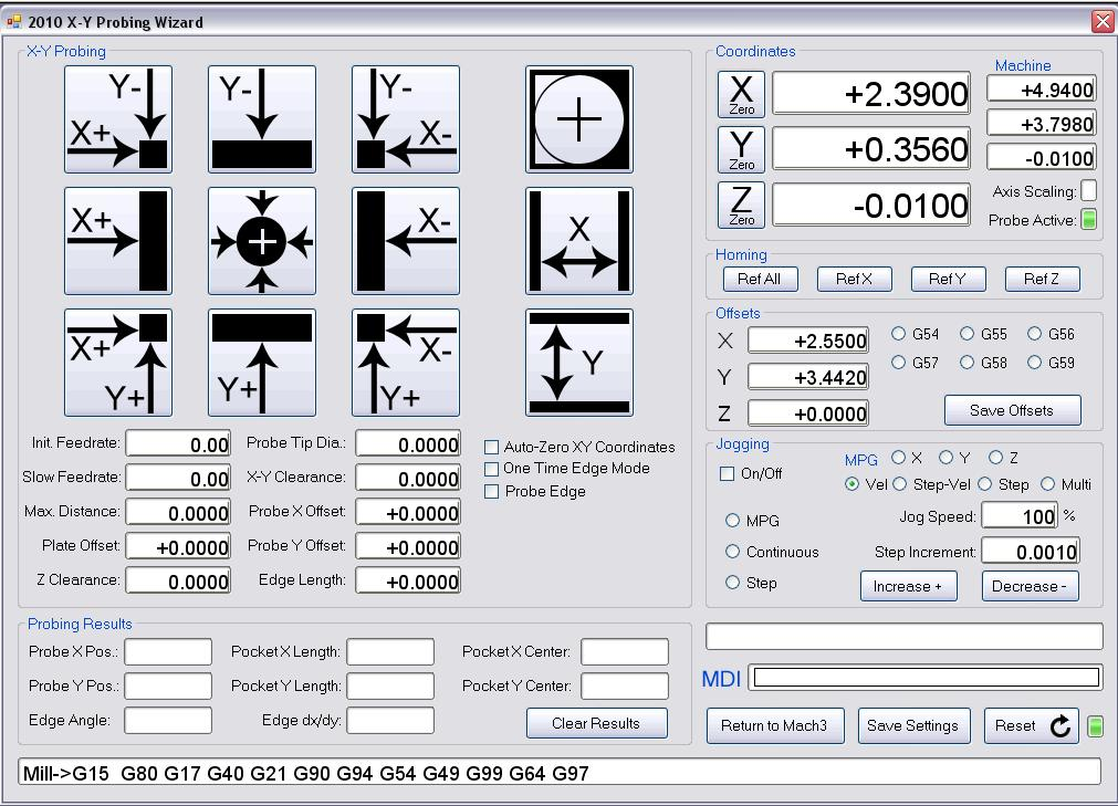

Hi Norbert
I agree that we need some better touch off features. If you want to go that route with touch off then you might as well look at a lot more options like circle centres and many more.
IMHO we need a tab with touch off features and leave the run of the mill stuff as it is. Once you start down this road you will find that even the space at the bottom is not enough for what can be done.
The attached file shows what is a good set of touch off functions. That is why I think we need a tab for this.
You must also consider lathe users.
Would it be hard to dock this probe gui in gmoccapy?
linuxcnc.org/index.php/english/forum/40-...gcgui?start=30#37039
github.com/cnc-club/linuxcnc-features
Then all the "hard" probe stuff is done already.

30 Mar 2015 08:37 #57303 by ssalrin
Replied by ssalrin on topic Gmoccapy - A new screen for linuxcnc
I am wondering if it could be created as a standalone GladeVCP "tab" that could be embedded into any GUI.
I have been thinking of setting up something similar as a tab in my Touchy config.
Andy,
You and I have had a similar discussion in Emc-users. This probing tab is exactly what I want, and more. If you could pull this off my work would be done! Except for the pesky 4th axis post processor thing.
Scott

30 Mar 2015 17:48 #57309 by andypugh
Replied by andypugh on topic Gmoccapy - A new screen for linuxcnc
I have done a bit of work on it. But I rather got distracted by fun ways to store multiple scalable button images in a single SVG file...

30 Mar 2015 18:03 #57311 by mariusl
Replied by mariusl on topic Gmoccapy - A new screen for linuxcnc
Hi Andy
How far down the road are you with this. I am contemplating to start on this as well. It is much needed. I bought the software (Mach version) that you see in the pictures above some time ago when I still used Mach. I bought that package just for the probing but alas I no longer run my machines on Mach although I am still a distributor for them.
Maybe we can collaborate on this if you need to?
Regards
Marius
www.bluearccnc.com

30 Mar 2015 18:21 #57312 by andypugh
Hi Andy
Not very far. I found myself indecisive about whether the best solution was a standalone monolithic tab or a set of GladeVCP widgets that could be added to existing tabs.
(Also, I couldn't decide between building the tab with PyGTK or whether to format it with a Glade XML file, which would require them to be widgets)

30 Mar 2015 23:10 - 30 Mar 2015 23:18 #57321 by newbynobi
Replied by newbynobi on topic Gmoccapy - A new screen for linuxcnc
@ssalrin,
I do have plans to include such a probing page, but because of leak of time I did not begin yet.
The image from Mach3 does IMHO contain to much information. I would prefer a page with the probing button on the left side and some input pages on the right, only showing the relevant information, may be even with a small image.
If you want to do the first steps, please make the corresponding button Icon and send them with a GPL license.
Make a first design of how it should look, a small basic documentation. And we do need the corresponding ngc-code.
I will check how difficult it would be to integrate linuxcnc-features in gmoccapy. I do thing linuxcnc-features should be a part of linuxcnc and should standard for 2.7 release.
I will ask Mick about his opinion.
Norbert
