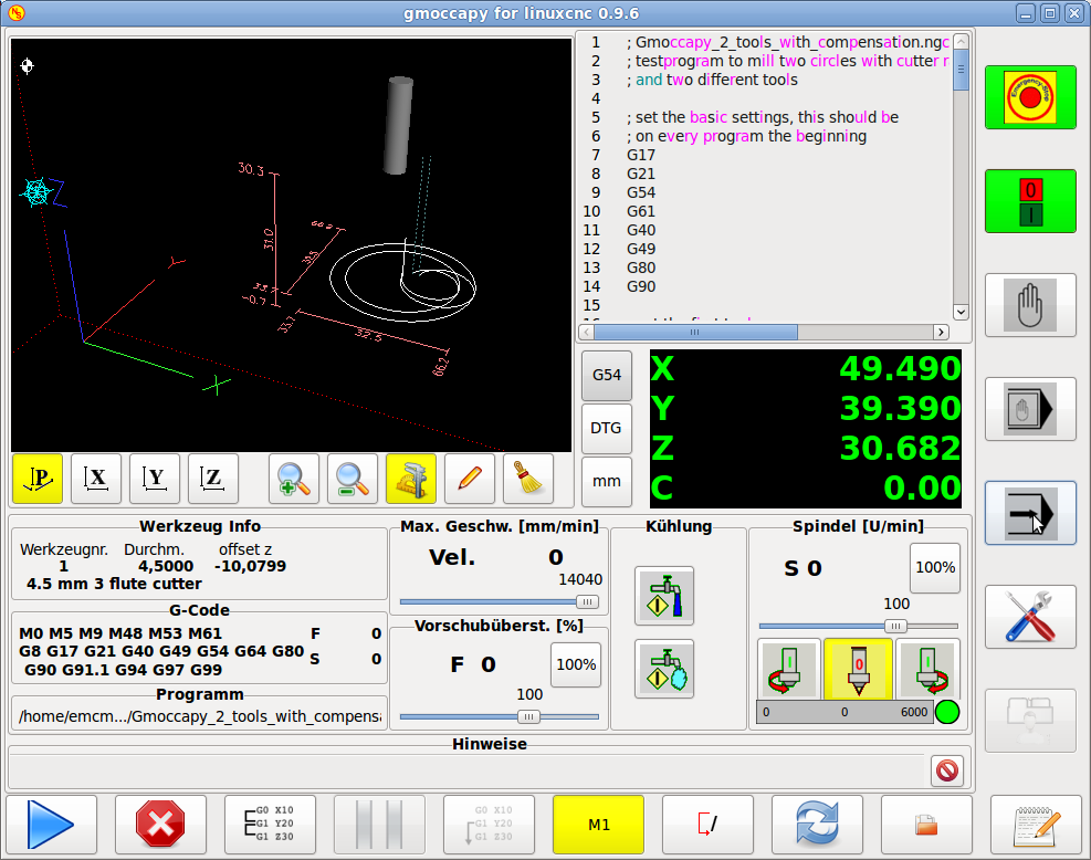

gmoccapy-0.9.6 - 4-th axis is included
not even 100 minutes old!
ver. 0.9.6
- included the 4-th axis, buttons will change according to INI file settings
- corrected not taken care of PROGRAM_PREFIX path set in the INI file
- G95 Bug solved, it was caused from sim_spindle_encoder.hal gibing motion.spindle-in in RPM instead RPS,
gmoccapy use now a modificated sim_spindle.hal from axis lathe.hal
- cleared a warning of missing handler
Have fun! And please do a lot of testing.
