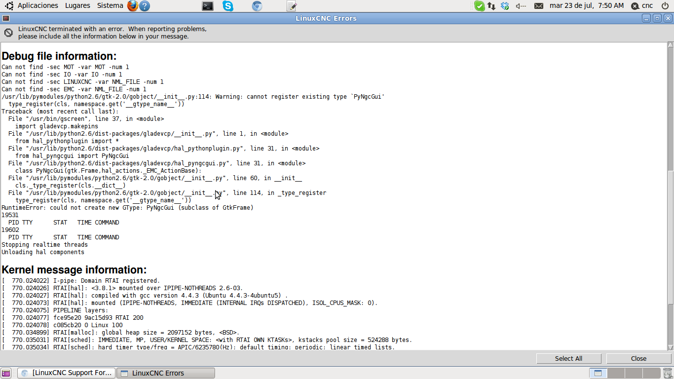

23 Jul 2013 19:53 #36935 by jlviloria
Replied by jlviloria on topic Gmoccapy - A new screen for linuxcnc
Hello,
<< git pull and git reset >>> to see the improvements made, but will not leave me any GScreen and gmoccapy configs, I get this error.
Jorge Viloria
24 Jul 2013 02:59 #36954 by newbynobi
Replied by newbynobi on topic Gmoccapy - A new screen for linuxcnc
Halo Jorge,
you must have tested pynggcgui before it was included in linuxcnc.
Which means it's still there in lib/python or lib/python/gladevcp
purge all the versions that are not included in the official source.
GObject is trying to register two programs with that same name.
I got caught with it too :) I mentioned it in the maillist.
The quote is an email from Chris, because I also traped in it. I made a new git clone and transfered later my data to it.
Norbert
The following user(s) said Thank You: jlviloria
24 Jul 2013 03:48 #36957 by jlviloria
Norbert, thanks
I have not been able ... delete everything and install everything again and nothing.
Jorge
24 Jul 2013 23:59 #36998 by newbynobi
Jorge,
what exactly have you done?
I solved the problem, just renaming my old linuxcnc_dev to linuxcnc_dev.org
and than I made a new git clone
and than just follow the WIKI.
Norbert

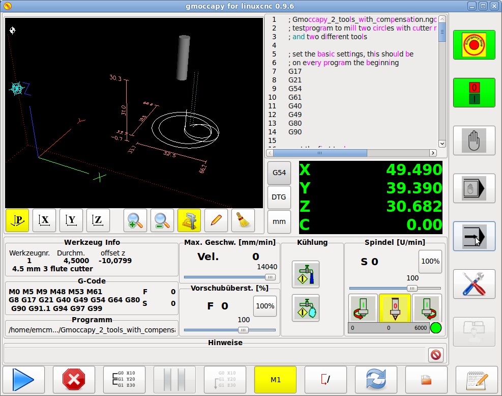

25 Jul 2013 03:12 - 25 Jul 2013 03:15 #37006 by newbynobi
Do you like the following?
And my question, what is new???
(The GUI is in German, but is also availible in English ;-)
@Marius, it is the cherry on my cake ;-)
Norbert
Waiting for Chris to push!

25 Jul 2013 03:44 #37008 by jlviloria
Norbert, thanks
I did just that, I made another LinuxCNC-dev, and nothing came back to install the same.
Jorge

25 Jul 2013 13:04 #37014 by newbynobi
@Jorge,
Than your system does mx something.
Unfortunately I am not able to help from here.
Have you done a make clean?
And have you done all the config and make things in the correct directory?
Norbert
