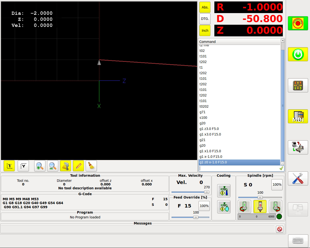

08 Nov 2013 12:57 - 08 Nov 2013 14:20 #40657 by DaOne
Replied by DaOne on topic Gmoccapy - A new screen for linuxcnc
I am having a problem with the lathe screen in imperial mode. The diameter is displaying metric while the radius is showing imperial. I also show metric in the "Max Velocity" box when I jog the axis.
In my ini I have it setup for imperial like this...
[TRAJ]
LINEAR_UNITS =     inch
[RS274NGC]
RS274NGC_STARTUP_CODE = G18 G20 G40 G49 G54 G80 G90 G94 G8 M9 M5 G64 P0.005
Here is a screen shot...
Is there another setting I need to make or is this a bug?
Thanks,
Wes

08 Nov 2013 16:01 #40663 by DaOne
Ok, I got the "Max Velocity" box fixed by changing the "gmoccapy_handler.py" file to this...
_MM = 0                 # Metric units are used
_IMPERIAL = 1           # Imperial Units are used
Still the diameter DRO is in metric no matter what.

09 Nov 2013 16:56 - 09 Nov 2013 18:35 #40682 by newbynobi
Replied by newbynobi on topic Gmoccapy - A new screen for linuxcnc
Halo Wes,
you got me!
That is a bug!, better there are two of them!
Do we need 4 digits for the max and actual feed boxes?
We are running out of space setting F125.1234, getting to long stringnumber!
What about the tool Info part, it shows 3 digits by default?
I will fix that as soon as possible!
Norbert

09 Nov 2013 19:46 #40683 by newbynobi
I just sent a patch to Chris, asking him to push the changes.
So the bugs will be fixed as soon as Chris does the push.
Test the gmoccapy_lathe_imperial.ini
All DRO are now in machine units
Tool offsets are shown with 4 digits
and the vel and feed labels do have two digits at this moment,
if you imperial users want more digits, I will add them. ;)
Norbert
The following user(s) said Thank You: DaOne

11 Nov 2013 02:54 #40710 by newbynobi
gmoccapy 0.9.8.4 has been pushed
fixed some bugs on displaying labels in wrong units while in imperial mode
ver. 0.9.8.4
- diameter dro does not show imperial units, even if
machine units are imperial, fixed.
- tool info only with three digits in imperial mode,
now 4 digits
- active feed and active vel label not in machine units,
if in imperial mode, fixed
- cosmetic changes to gmoccapy_lathe.ini
- introduced a imperial lathe ini
Norbert
