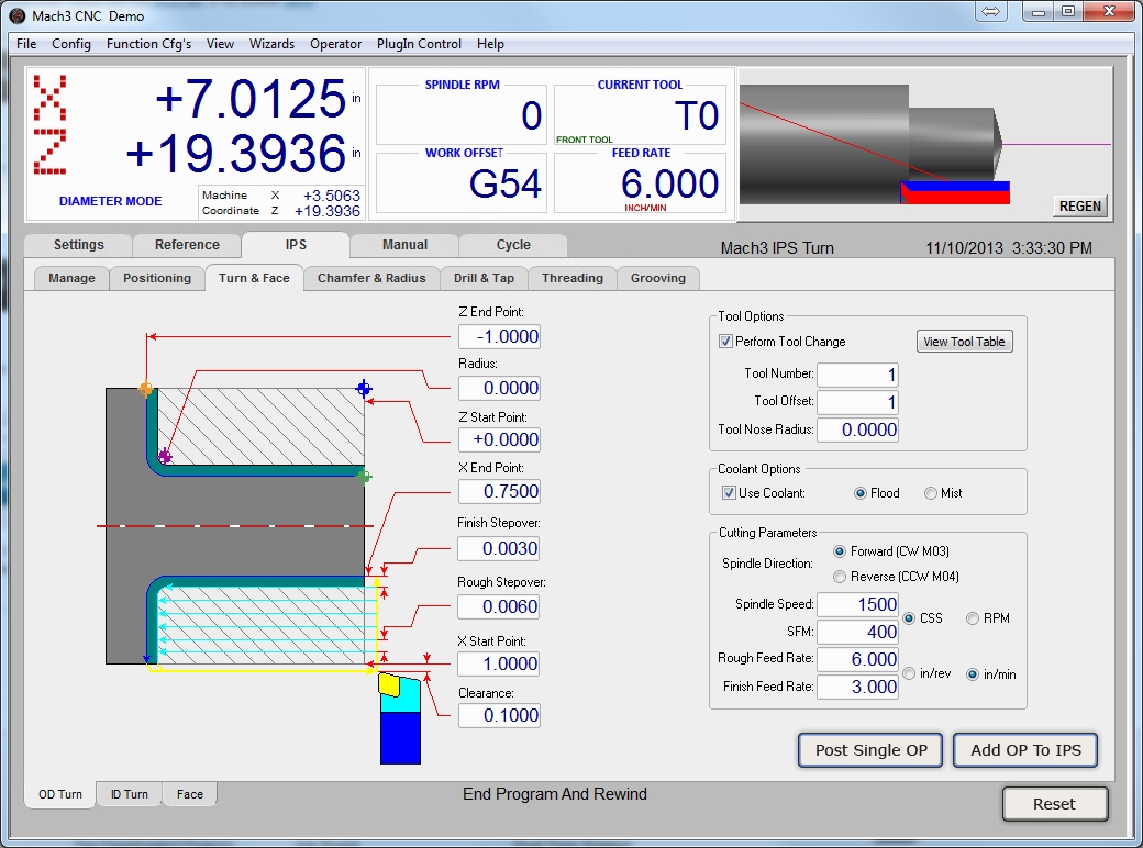

That comes to my next question. Are you familiar with IPS? Here is a PDF of what I am talking about..
www.haascnc.com/doclib/manual/es0610.pdf
Its basically an interactive program builder. I had a working model of this for mach3 but still learning python in order to do something such as this on LinuxCNC. Maybe someone who is proficient in coding had interest in such a thing? Just thought.
Can't wait to see your industrial screen! Need a beta tester? :D
Thank you for all your work on this.

IPS, YES! Rene, German Guy has all the cycles nearly finished and I was able to show some examples on the German linuxcnc integrator meeting, generating code with gmoccapy, we generated 700.000 lines in less than 10 Seconds, but unfortunately the GUI crashes with that amount of information, because of the preview window. I am looking for a solution.
So the IPS will be called ShopfloorPro and will take some more time, just give us a year or so.
Norbert

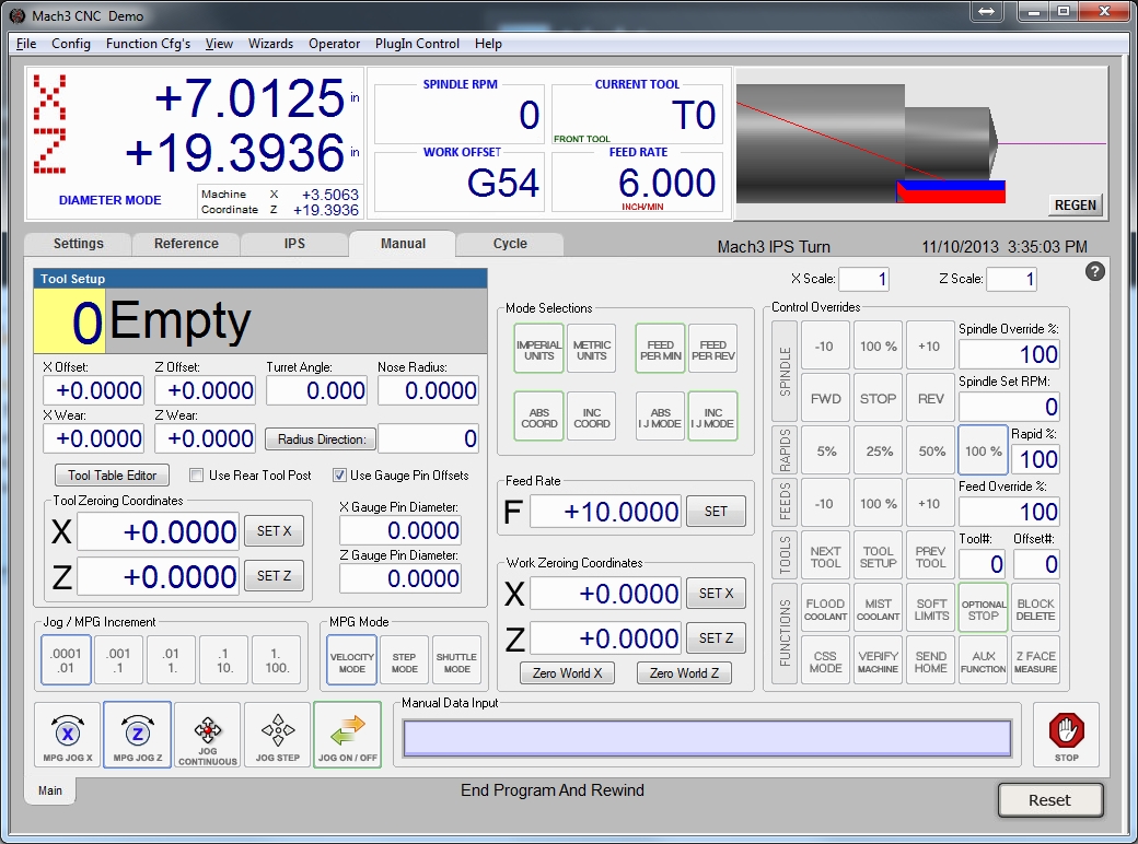

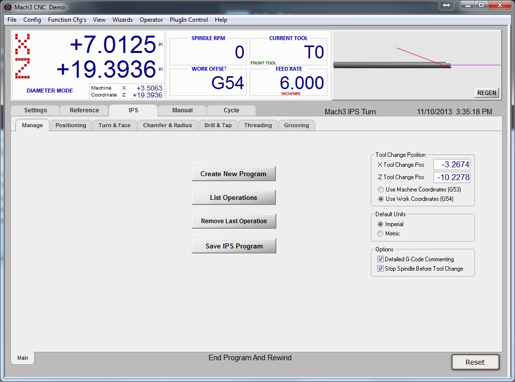

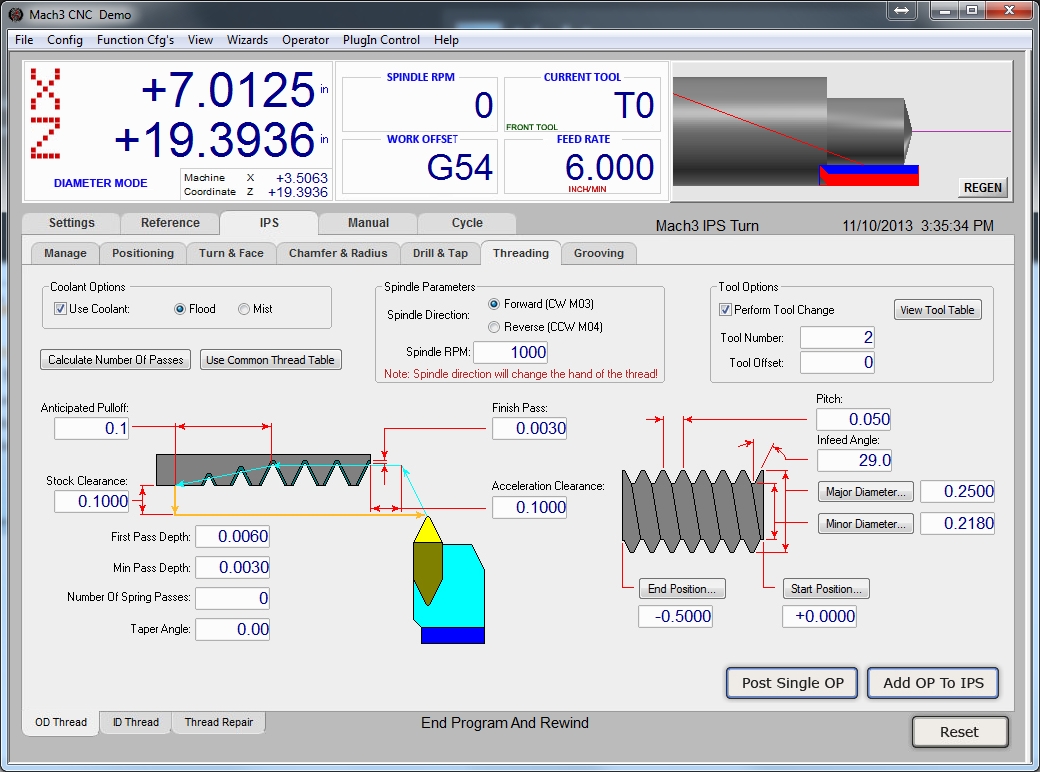

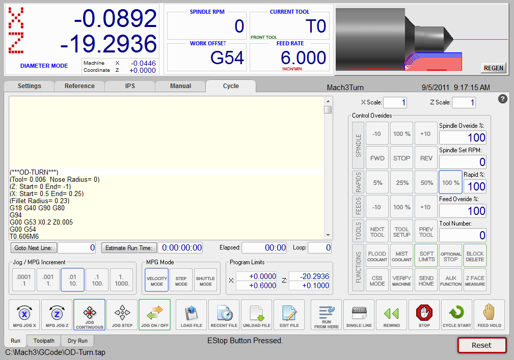

11 Nov 2013 07:08 - 11 Nov 2013 07:45 #40718 by DaOne
Replied by DaOne on topic Gmoccapy - A new screen for linuxcnc
Norbert,
Here is a link to the image files I made for my screen set.
dl.dropboxusercontent.com/u/75606622/IPS_IMAGES.zip
Wes
Last edit: 11 Nov 2013 07:45 by DaOne.
11 Nov 2013 07:38 #40719 by DaOne
Norbert,
Here are a few screen shots of my design. Hopefully it will help spark some new ideas.
Let me know you thoughts.
Wes
