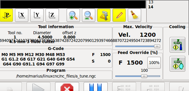

06 Mar 2014 04:54 #44466 by mariusl
Replied by mariusl on topic Gmoccapy - A new screen for linuxcnc
Norbert
Please be patient with the panel :blush: I am having several problems with the manufacture. The bezel is a problem and some cash flow to bring a larger quantity of displays in from the east. Some small problems with internal cables as well. I will not forget your panel and the first production unit has your name on already.
Have a look at the screenshot in the tool information area. Some strange numbers.
Regards
Marius
www.bluearccnc.com
06 Mar 2014 05:09 #44467 by newbynobi
Replied by newbynobi on topic Gmoccapy - A new screen for linuxcnc
Hallo Marius,
I have never seen such numbers on my PC !
May be it is one of your bit-coins, trying to escape ;-)
Can you reproduce that behavior? I guess it is more a problem on your computer.
Norbert
