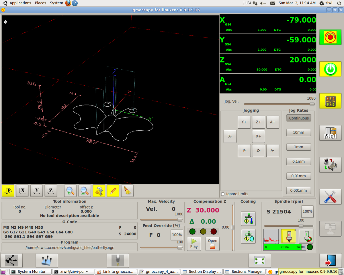

I share additions to Gmoccapy made ​​for my own needs:
-compensation-Z (Allows auto tracking of an uneven surface by milling PCB tracks. It pre uses probe and g-code compensation_map.ngc to draw map of a surface in txt file)
-management Huanyang VFD on modbus (Control bin file "hy_vfd" should be copied in /bin )
-management wireless joystick Logitech Freedom
my machine - gmoccapy_4_axis.ini
Last edit: 03 Mar 2014 04:25 by verser. Reason: add file

could you please explain a bit more in detail?
I downloaded the files, but it is very cumbersome to search for the differences in the files.
As far as I see, you modify the complete glade file, why?
Please take a look at gmoccapy_plasma, as all the changes there are related with emmbedded-tabs, a custom handler file and a custom hal. If you follow that way, your changes will not be lost after every update!
I see you are using 0.9.9.9.16, be aware, if you update now you will get 1.0.4 and most of your changes will to be redone, as the file locations has changed.
You will find gmoccapy.glade and gmoccapy.py at /src/user_intf/gmoccapy, if you modify one of the files you will have to do a make after the modification!
Norbert

03 Mar 2014 20:07 #44357 by verser
Replied by verser on topic Gmoccapy - A new screen for linuxcnc
Helo Norbert,
I just like the interface of gmoccapy and quickly insert it necessary for me to function and
understood that I would lose the ability to update.
Now I will use your recommendation and look carefully gmoccapy_plasma and try to make right my additions in version 1.+
and write some readme.txt

If you need any support, just ask! I am very interested in the Z-Axis compensation, because I also like to mill PCB and know well about the leveling problem!
May be we can add that option as a separate INI config like we did with plasma.
Norbert

Ok, I got acquainted with a gmoccapy_plasma , it is clear all, soon make addition Z-Axis compensation as a separate INI config as EMBED_TAB_LOCATION = box_coolant_and_spindle
