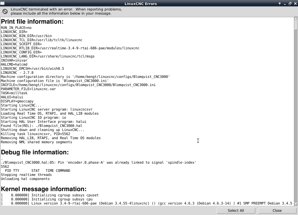

You have 3 lines that are essentially trying to do the same thing twice.
These two lines
net spindle-index => encoder.0.phase-Z => encoder.0.phase-A
net spindle-index <= parport.0.pin-10-in
and this one line are functionally equivalent, except for the signal name.
net spindle_index parport.0.pin-10-in => encoder.0.phase-A => encoder.0.phase-Z
Here I've deleted the offending line and reconnected the original parallel port pin line.
These two lines

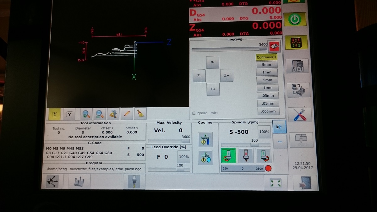

Now no errors so I can start. But still no rpm show on screen.
I am a bit suspicious on the pulse length that Mach needs quite long pulse.
So maybe there must be some filters schmitt-trigger to make pulse suitable for LCNC.
How to measure incoming pulse width on pin 10?
Found the halscope in gmoccapy. pulsewidth 45/46 ms at low rpm of approx 200rpm

You can easily look at parport.0.pin-10-in with Halscope.
But there are some other issues.
Not sure why you added a scale component for the encoder, the encoder has a scale built in.
Try this:
Try this:

Scale is in Norberts code
No difference, still same 45-46ms pulse width

Added that line, nothing. No numbers showing real rpm yet.
