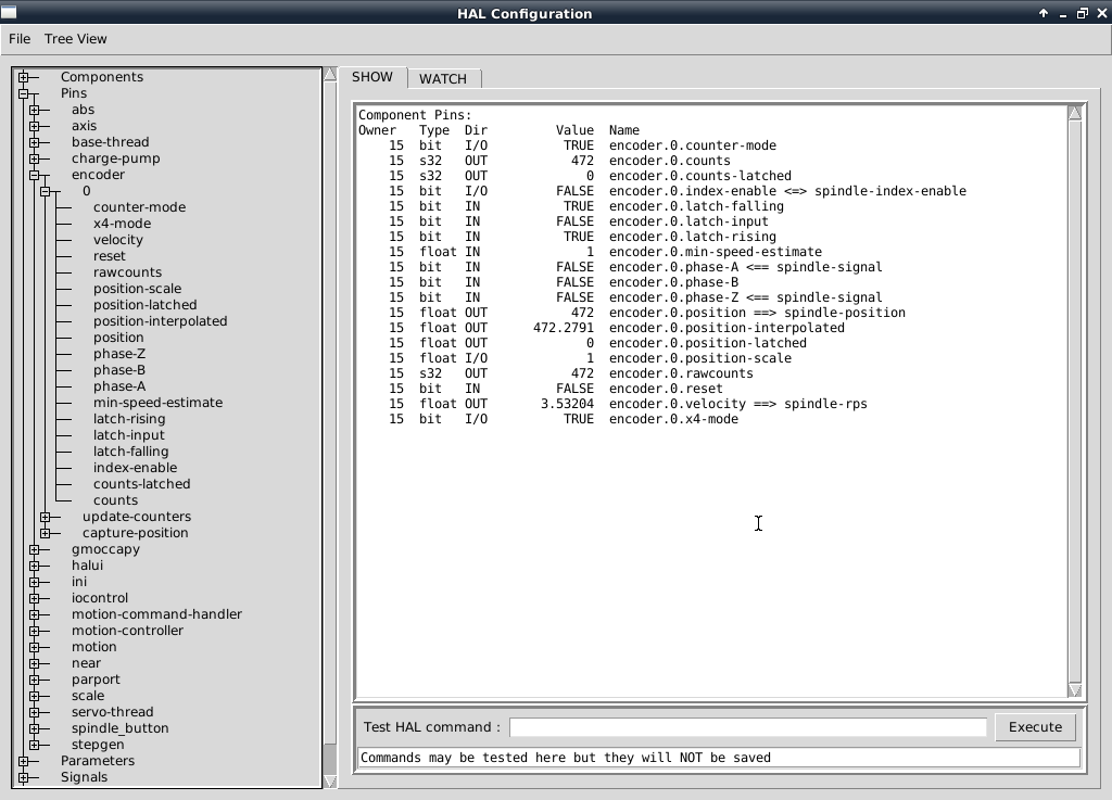

Please use Halshow and inform, about the results of all pin related to encoder.0
Norbert

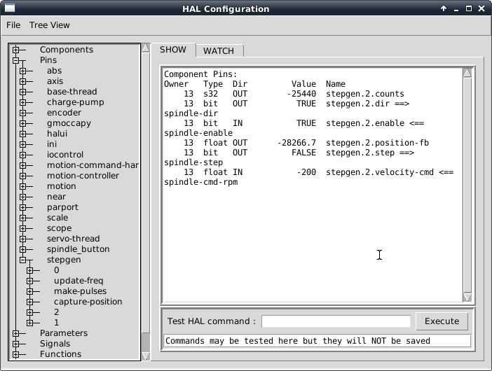

30 Apr 2017 16:50 #92356
by tecno
Replied by tecno on topic Spindel problems in Gmoccapy

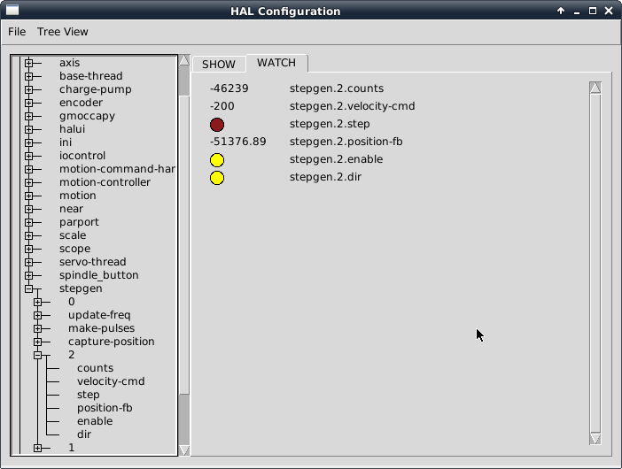

30 Apr 2017 16:58 #92357
by tecno

30 Apr 2017 17:01 #92358
Replied by tommylight on topic Spindel problems in Gmoccapy
On the left tree view there is encoder under pins, find there encoder.0 and show what is going on while working.Please use Halshow and inform, about the results of all pin related to encoder.0

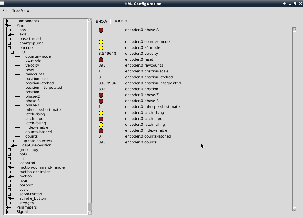

30 Apr 2017 17:23 #92359
by tecno

01 May 2017 00:52 #92400
Replied by andypugh on topic Spindel problems in Gmoccapy
encoder.0.velocity is showing a value (equivalent to 213 rpm) so it is something wrong in HAL, we can be certain.
You can follow the trail (encoder.0.velocity is shown going to the spindle-rps signal) and see where it breaks.
Probably a component that is not added to a thread, or possibly a hyphen/dash confusion in a signal name somewhere.

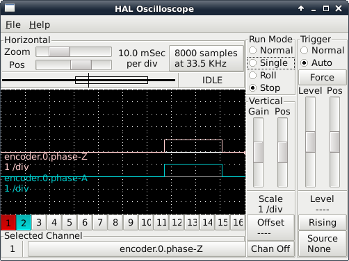

01 May 2017 08:24 #92411
by tecno
Just to get clear that I understand this.
Velocity is commanded to 200rpm and you read encoder.0.phase-Z to 213rpm, is this correct?
If so remember there is this LM circuitry converting steps to V that can be off and not tuned in.
If not = I am lost here and can not wrap my head around this.
"You can follow" Do you say that I need to use Halscope and look at the signal flow?
Is it this you want me to follow, I can sure try.
net spindle-rps encoder.0.velocity => scale.0.in
net spindle-rps motion.spindle-speed-in
net spindle-rpm-not_abs abs.0.in <= scale.0.out
net spindle-rpm abs.0.out
net spindle-position encoder.0.position => motion.spindle-revs
net spindle-enable motion.spindle-on => stepgen.2.enable
net spindle-cmd-rpm stepgen.2.velocity-cmd <= motion.spindle-speed-out
net spindle-comanded near.0.in1
net spindle-rev_per_min near.0.in2
net spindle-at-speed near.0.out => motion.spindle-at-speed
Cheers
Bengt
