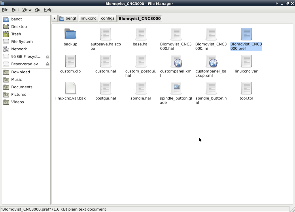

No there is not any way to open terminal
- Posts: 19902
01 May 2017 16:21 #92458
Replied by andypugh on topic Spindel problems in Gmoccapy
You would open the terminal in Linux, not from the LinuxCNC GUI.
It is possible to type in commands in the Halshow window, but there is no command-history or tab-completion there.
Another thing you could try, to check that the postgui HAL file is actually being called, is to have a "loadusr halmeter" at the top of the file. If the halmeter window appears, then it probably is.
Also, try starting Linuxcnc from the command-line, I think it lists all the HAL files it finds. Perhaps there is an error message to be seen there.

Apparently it is not loading as no halmeter appears

halcmd net spindle-rpm gmoccapy.spindle_feedback_bar
I managed to size down gmoccapy so I could start terminal and now I have rpms showing

That is why I keep asking you what the file names are, and if they match the ones in the INI file.
You have two HAL files with "postgui" in the name. Only one of them is specified in the INI. Is that the right one?
Is this a naming issue of the postgui file name perhaps?

Names are correct.
But can postgui have name without custom_ ? Is it so that custom_postgui.hal is expected and hardcoded somewhere in the code?

No, only the files specified in the INI are used.
But you have two files, and you are only referencing one in the INI, the other is commented out.
(And I am not sure that it is possible to call more than one postgui file).
It might be that the right file is being called, but that it has an error so drops out before the critical line. (but the "halmeter" line seems to have disproven that theory.)
Which of your two postgui files contains the net command for the spindle speed bar? (I am sure I have asked this before)

postgui.hal
