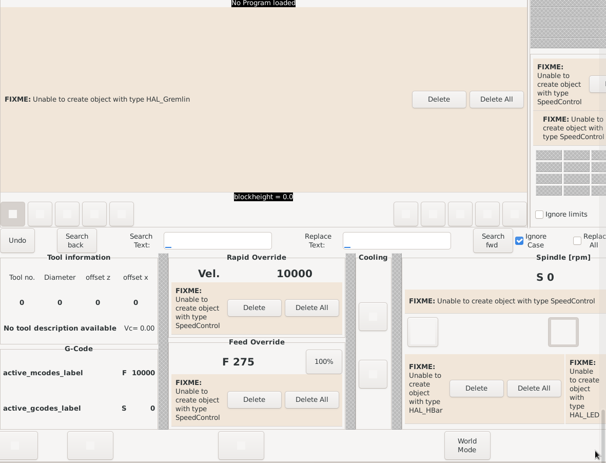

OK thanks if this is the solution. However it changes the layout of elements during opening, I will have to arrange them again.
I thought the gladevcp of 2.8.4 is better and is available in 2.9.

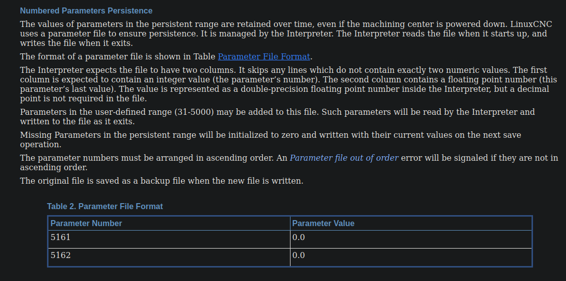

What should I do to ensure that the values I write are not lost and persist when Linuxcnc is turned off and on?
- Posts: 4818
- Thank you received: 2176
22 Aug 2024 05:50 - 22 Aug 2024 06:47 #308366
Replied by Aciera on topic İnstall glade
If you add numbered parameters to your .var file, the added variable numbers should become persistent.
[edit]
www.linuxcnc.org/docs/html/gcode/overvie...:numbered-parameters
As an example if you want parameter #1000 to be persistent you would add this line to the top of your .var file (mind the <tab> in between the two numbers and make sure LinuxCNC is not running when you modify the file):
[edit]
1000 0.0Attachments:

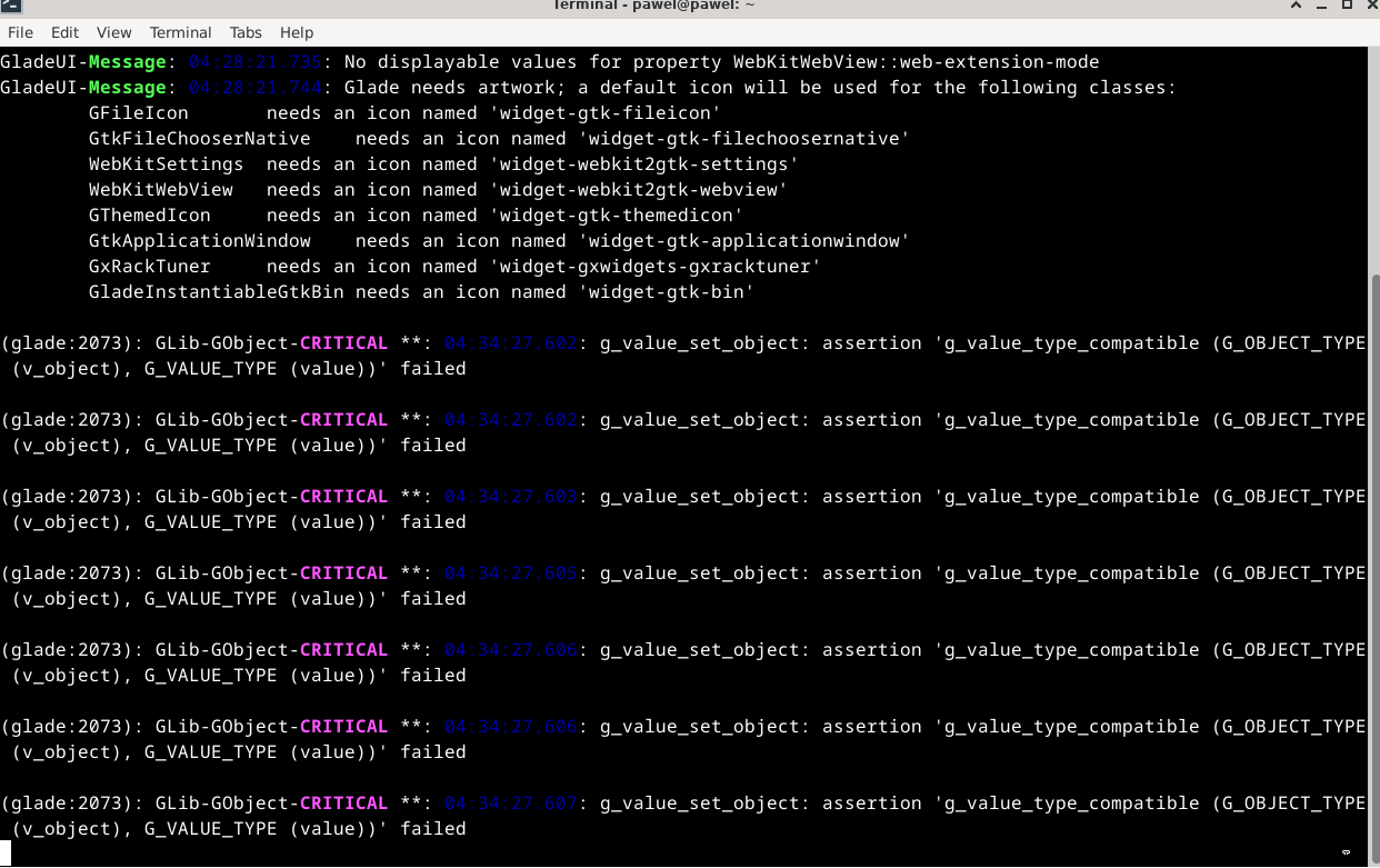

Then when I open gmoccapy.glade file it looks like widgets are not imported.
Aciera could you help?
Replied by pawel77 on topic İnstall glade
I have LinuxCNC 2.9.3 Debian 12 Bookworm PREEMPT-RT ISO , and when i start glade some messages appears.On a locally built (RIP) installation open a terminal and navigate to your linuxcnc installation folder:
[/code]source scripts/rip-environment then to start glade: [code]glade once glade has started, check if the linuxcnc glade widgets have been imported (ie widgets named 'HAL_....')

Look like glade is unable to find the LinuxCNC specific widgets.
If you are on a locally built installation (RIP) then you need to setup the environment before starting glade:
If you are running a package installation (eg if you have installed linuxcnc from an .ISO or from the package manager ) you need to point glade to the linuxcnc specific glade widget library.
I'm not familiar with this setup but maybe this post helps:
forum.linuxcnc.org/48-gladevcp/48438-how...-glade-folder#266531
[edit]
I just checked on a new debian bookworm installation with linuxcnc installed from the package manager and all that was required was 'sudo apt install glade' to install glade. The widgets are found no problem.
