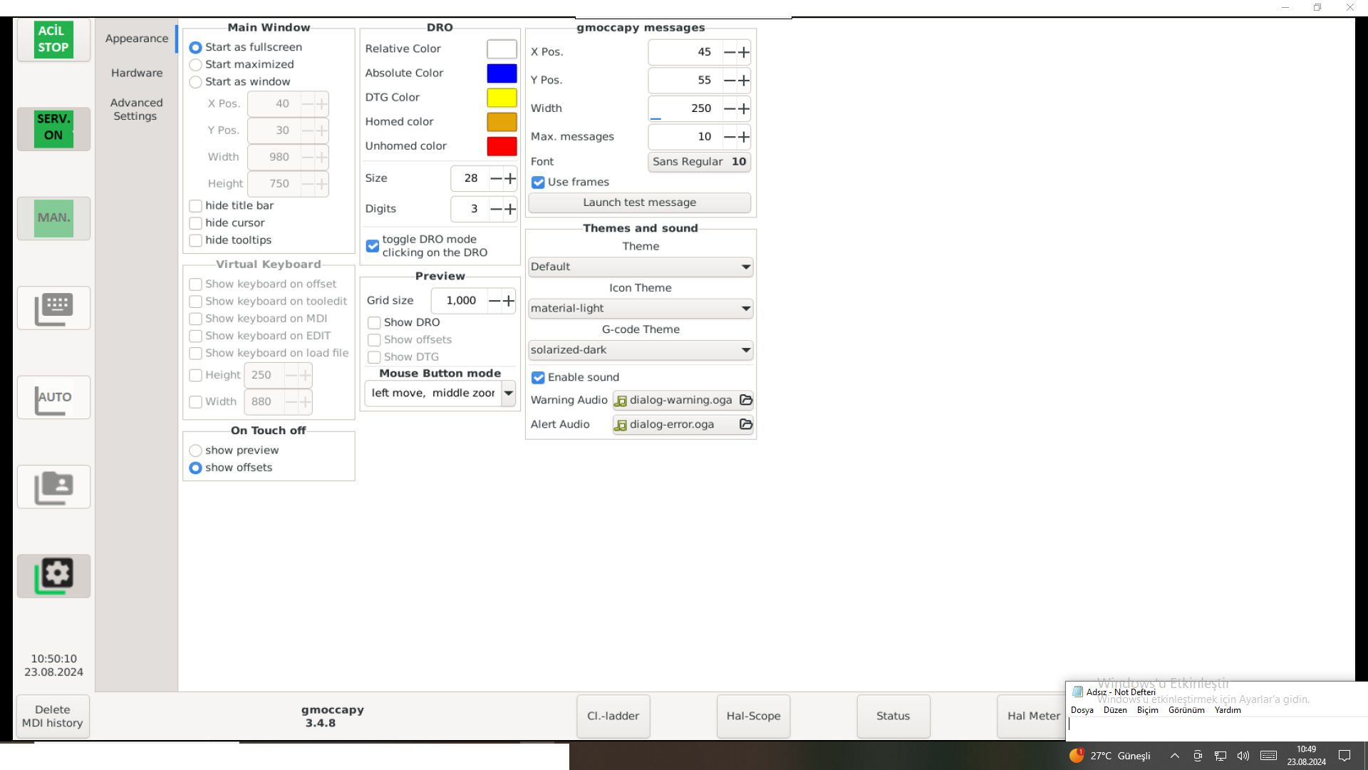

Replied by Aciera on topic İnstall glade
If you mean the 'Calibration' program from the bottom row in the settings page of gmoccapy, that is one of the external programs common to all GUIs. The source code for that can be found in the '/tcl' folder.

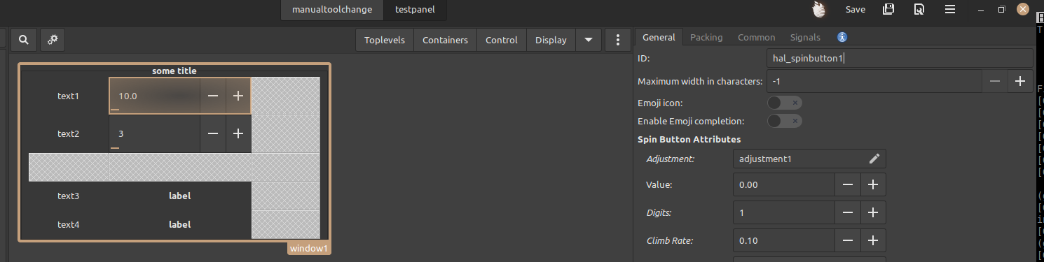

the quickest solution I can come up with is to use a handler script that monitors the spinbutton in the custom gladevcp panel and saves the current value to a file if it changes. On opening the gui the script will set the spinbutton value to the value read from that file:
to try save this as 'gladevcp-handler.py' to the 'python' folder in your config:
then change this line in the [DISPLAY] section of your ini file from:
to this (this will automatically load the handler file when the custom panel is loaded):

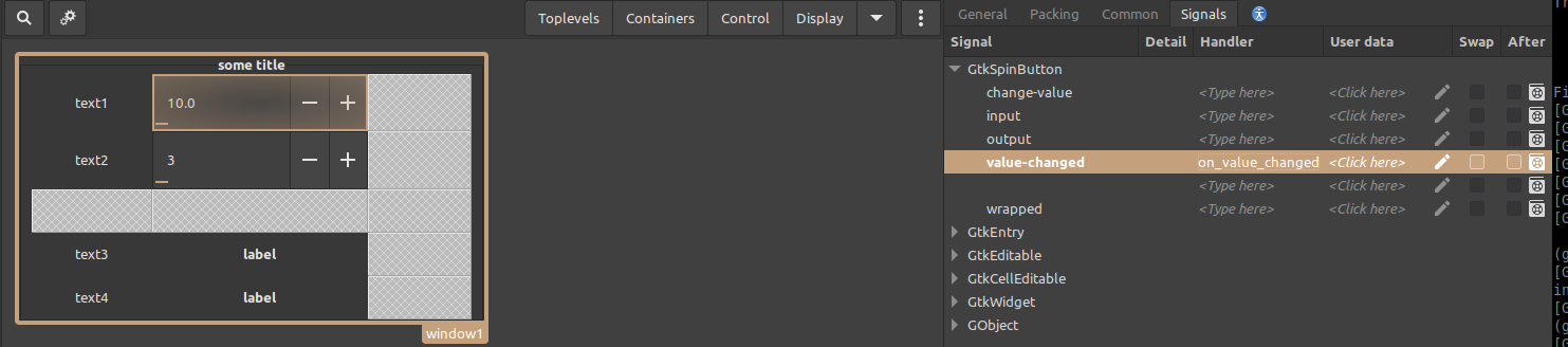

To get this to work with the 'testpanel.ui' I posted earlier you need to open the panel in glade and
1. make sure the 'ID' of the spinbutton to be monitored is 'hal_spinbutton1'
2. add the handler to the spinbutton by opening the 'Signals' tab and writing 'on_value_changed' in the 'Handler' column of the 'value-changed' line. With this a value change in the spinbutton widget will call the on_value_changed function in the handler script.

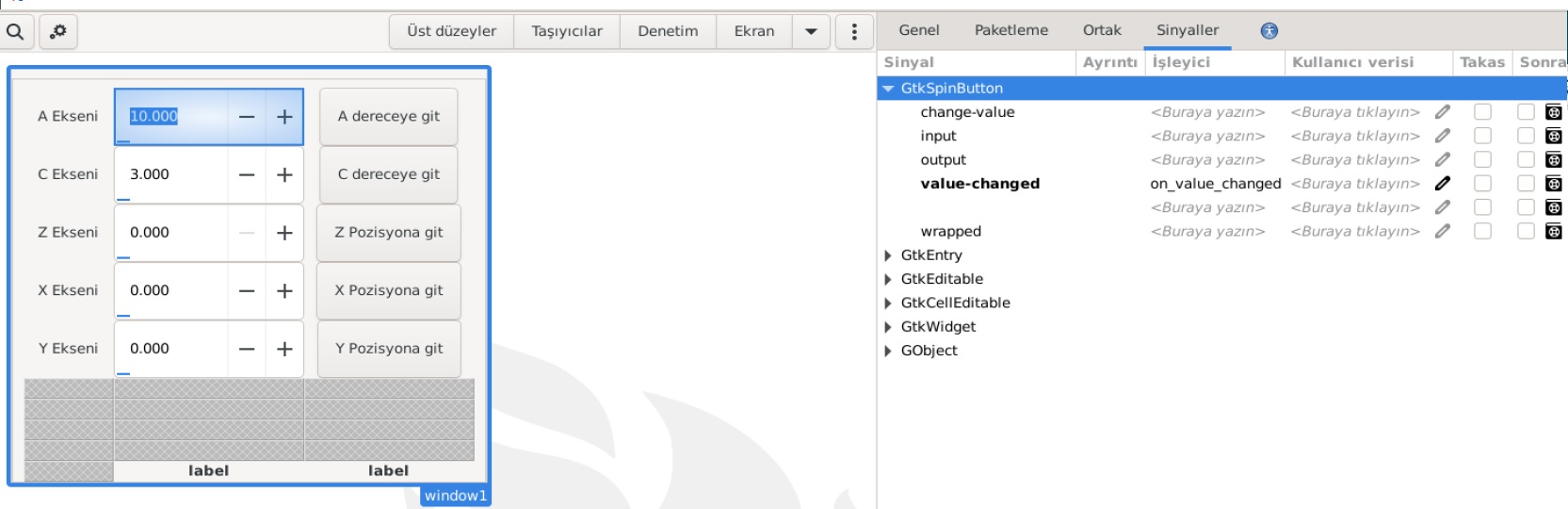

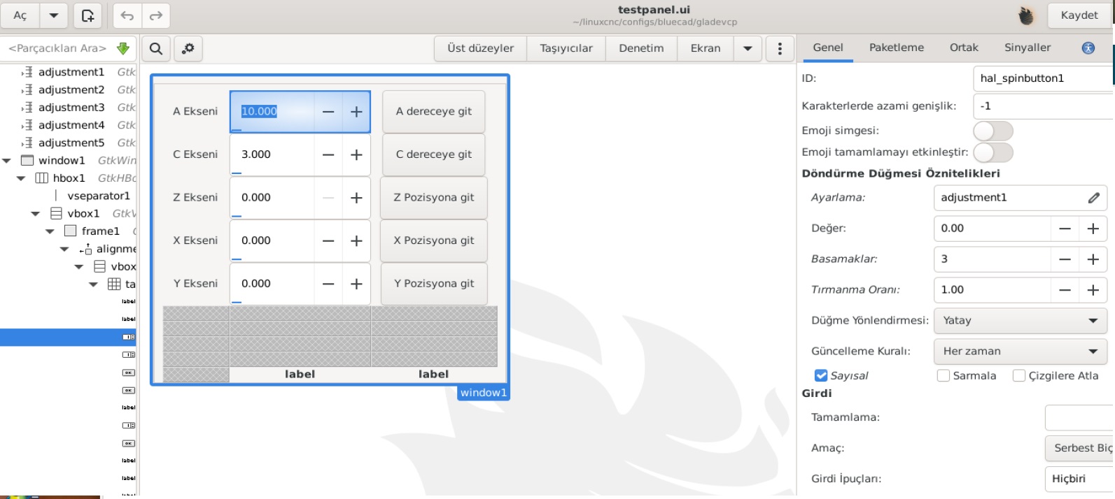

I tried all the steps many times, I think I'm making a mistake somewhere.
A folder has been automatically created inside the Pythhon folder, its name is __pycache__ and it contains the gladevcp-handler.cpython-311.pyc file.
1-I created a new file in the folder where the configuration files are located. name: gladepanel_parameter.txt
I marked the code you sent me as executable and saved it in the python folder as gladevcp-handler.py.
I replaced the line in my 3-ini file with this code
EMBED_TAB_COMMAND= halcmd loadusr -Wn test panel gladevcp -c test panel -u python/gladevcp-handler.py -H ./gladevcp/testpanel.hal -x {XID} ./gladevcp/testpanel.ui
4-I wrote on_value_cahanged in the vlue_changed section in the glade panel.
5-id=hal_spinbutton1
Last edit: 23 Aug 2024 15:20 by Moutomation.

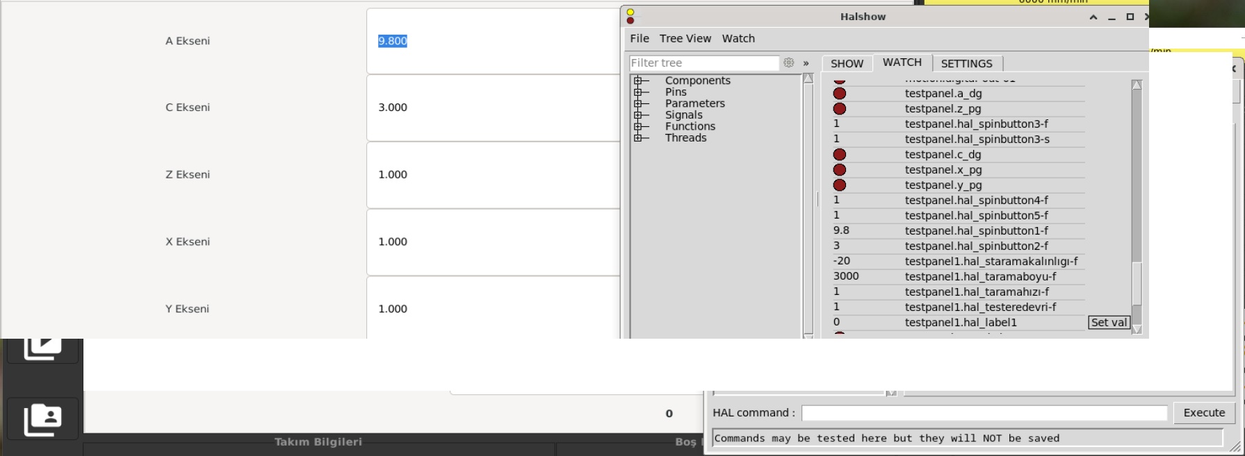

So what exactly is not working?
Notes:
1. forget the __pycache__ folder, that gets created whenever the script is run. You can even delete it, doesn't matter.
2. You don't need to create 'gladepanel_parameter.txt'. If it does not exist the panel will load the default value set in the .ui and it will be created on the first change.
Open the 'Halshow' tool and check if you see your custom panel and it pins. If so does it also show a pin named 'number':
Finally are you getting any output in the terminal?
Notes:
