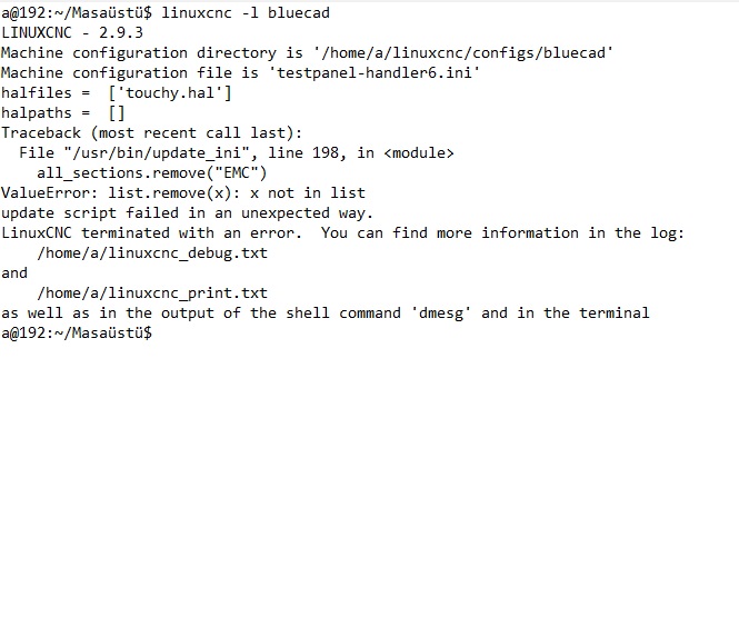

I have added the terminal output.the panel name is tespanel6,testpanel-handler6.py File "/home/a/linuxcnc/configs/bluecad/python/testpanel-handler6.py", line 13
changed_value = obj.get_value()
TabError: inconsistent use of tabs and spaces in indentation

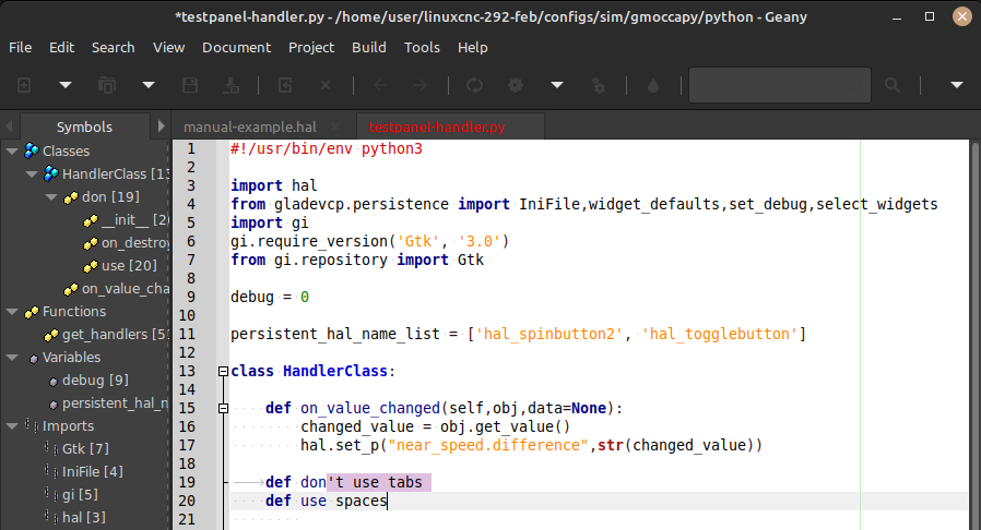

Python does not like if you mix tabs and spaces for indentation. I only use spaces no tabs so I presume you used tabs to indent the additional lines of code. delete the tabs and replace with spaces.

You can just use the command without the optional '-l'. This should bring up the config picker window:
or you can directly provide it with the .ini you want to open:
linuxcncor you can directly provide it with the .ini you want to open:
linuxcnc <your_path_here>/<your_ini>.iniPlease Log in or Create an account to join the conversation.

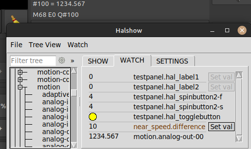

Right now I'm stuck on two issues: 1. Interfering with the hal parameters, 2. Changing the value of a variable in the hal from the g code file and displaying it in the gui. I think I should rest a little and try again when I'm fitter.

here is the relevant function as posted above:
def on_value_changed(self,obj,data=None):
hal.set_p("near_speed.difference",str(changed_value))Please Log in or Create an account to join the conversation.

Can you give me an example, how can I transfer a variable in the g code file to a variable on the status pin? For example, how can I connect the value #100 to the classicladder or hal pin?
Last edit: 28 Aug 2024 08:09 by Moutomation.
- Posts: 4811
- Thank you received: 2164
28 Aug 2024 09:11 #308882
will set the halpin 'motion.analog-out-00' to the value in parameter #100:
linuxcnc.org/docs/devel/html/gcode/m-code.html#mcode:m68
Replied by Aciera on topic İnstall glade
M68 E0 Q#100 will set the halpin 'motion.analog-out-00' to the value in parameter #100:
