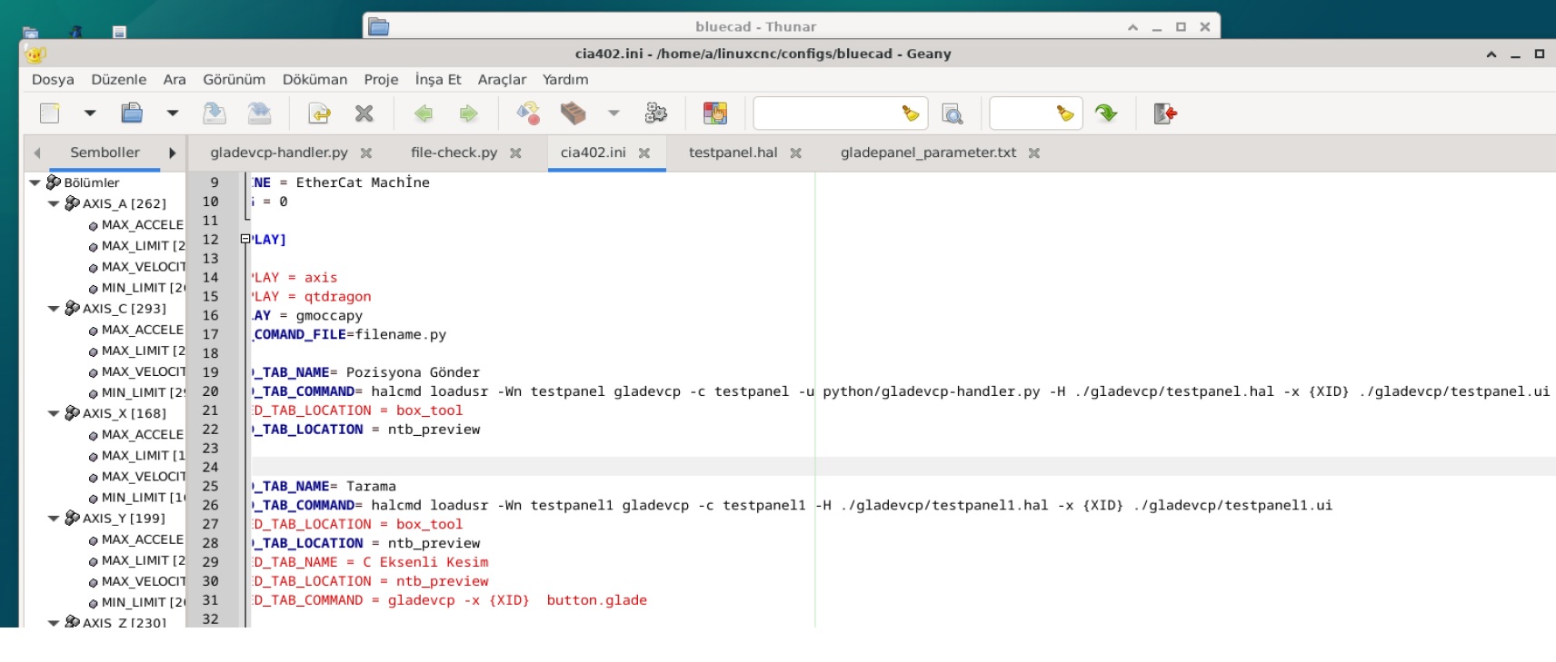

Terminal output?

Problem is your handler script does not load so start a terminal and type:
note the minus and lowercase letter 'L' should load the last config.
linuxcnc -lnote the minus and lowercase letter 'L' should load the last config.

Replied by Aciera on topic İnstall glade
Looking at the screenshot of your ini file it seems that you are loading both panels ('testpanel' and 'testpanel1') to the same location 'ntb_preview', not sure what that does but you may want to load the 'testpanel' to a different location like.
EMBED_TAB_LOCATION = box_cooling
Last edit: 23 Aug 2024 17:25 by Aciera.

I will try
I uploaded 4 separate pages to this location and now all 4 separate pages are working without any problems.
The only problem now is that they are not permanent.

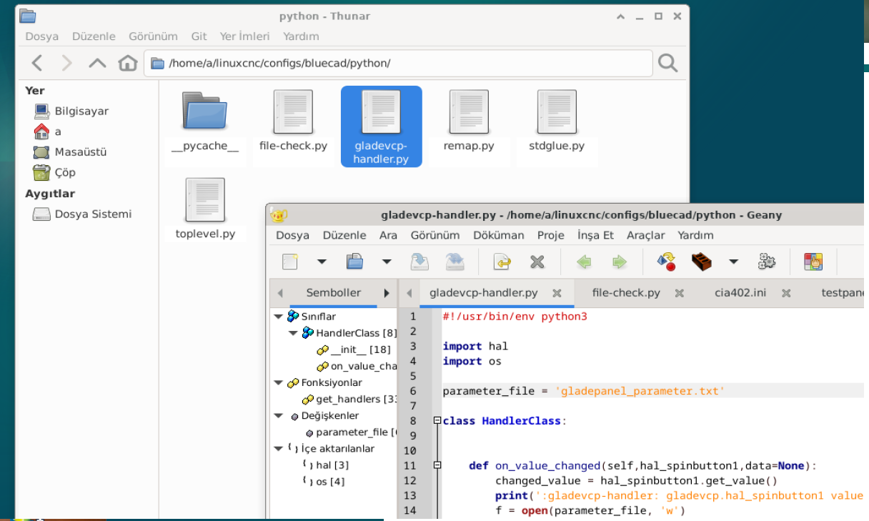

Yesterday, I tried many times and the value was not permanent. I turned off the CNC and went home. Now, when I turned it on, I saw that the value was permanent. And I am trying it now, there is no problem. The difference from yesterday is only the PC was turned off and on. Could this be related to this?
How can I make the second variable permanent on the same page?
Or how can I run a second Python code on the same page?
If I can run a 2nd python code. I will edit the code for the 2nd variable

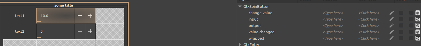

Actually there is a much easier way to do this as GladeVCP has a built in module for saving panel state on shutdown:
www.linuxcnc.org/docs/html/gui/gladevcp....on_gladevcp_shutdown
To try this you need to:
1. Delete 'gladevcp-handler.py' in your 'python' folder (since you seem to have more than one panel it makes more sense to name the handler file like the panel it serves)
2. Save this as 'testpanel-handler.py':
2. Update the tab command In the [DISPLAY] section of your ini to this:

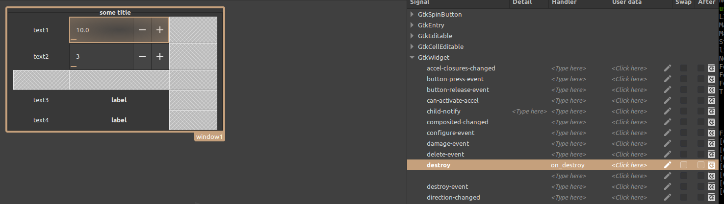

3. Open 'testpanel.ui' in glade and select the 'hal_spinbutton1' widget
a) Remove the handler from 'GtkSpinButton.value-changed' signal (that is the one we added last time):
b) Add 'on_destroy' as handler for the 'GtkWidget.destroy' signal :
That should be all.
Note:
- The 'on_destroy' handler only needs to be added to a single widget in the panel, does not matter which one as they all get destroyed when the GUI is closed.
- This will save/restore the state of the whole panel
- The data is stored in a file named 'testpanel-handler.ini'
- If you have more than one custom panel you can copy this handler file for each of them and replace 'testpanel' in the filename and the 'EMBED_TAB_COMMAND' with the name of the panel.
