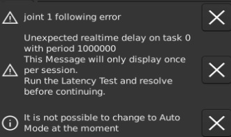

30 Aug 2024 13:59 #309026
by Moutomation
Replied by Moutomation on topic İnstall glade
- Moutomation
- Posts: 154
- Thank you received: 11
31 Aug 2024 09:01 #309078
by Moutomation
This problem is related to the computer. I have disabled all the features that I can disable in the BIOS and now the problem is not visible.
