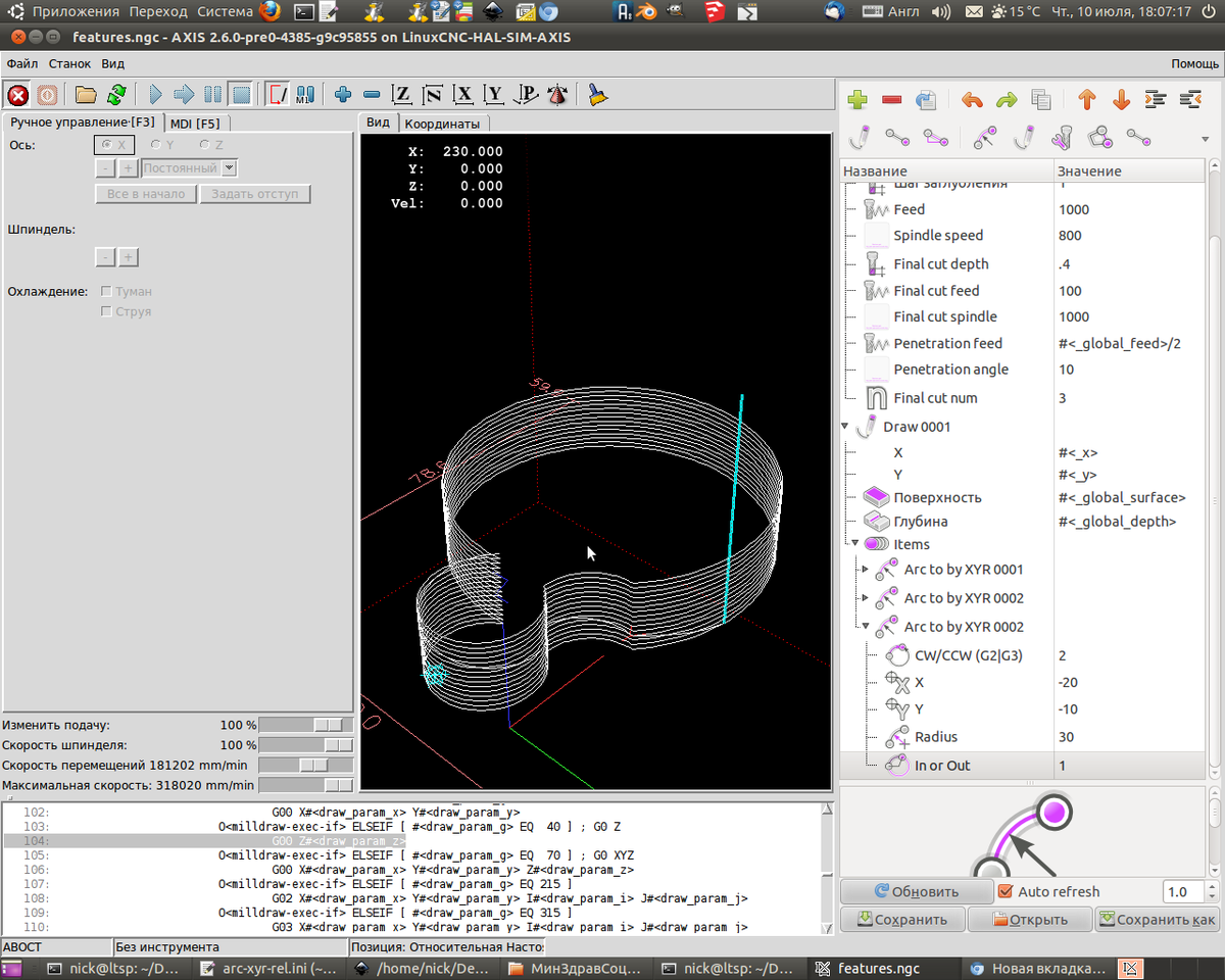

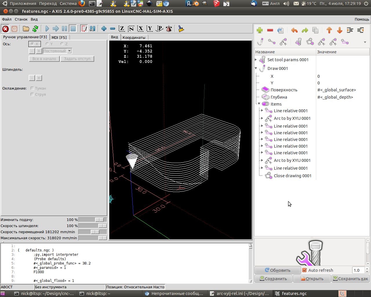

The very important thing for the machining is Penetration angle.
Some mills cannot penetrate material straight down and have to do it angled to the surface - so we will have a zig-zag, saw or spiral trajectory...
I do not know how is it called in English.
See the screenshots - there's a line which connects every layer and it's not vertical.

Replied by turbospeedskater on topic LinuxCNC Features - a kind of NGCGUI
Hi Nick,
that is one thing you can adjust with a parameter in my "universal GCode" .
Either you can go down in one place before you do the nect circle, or you can go down while doing the next circle.
Same is for pockets: You can adjust with a flag if you want to step out (for clearing the inner space) on one position,
or if you go out during the next circle.
Also adjustable via flags is, if you want to make a hole, a pocket, or a disc. SO you have to write everything for
geometry handling only once.
My idea behind was, to separate the handling of where to go down and/ or out and if the inner space should be cleared or not
from doing the geometrycal things (e.g. if we do a circle or a rectangle or whatever).
That is not 100% possile in GCode, but at least I have only 3 parts in the GCode (two suberotines and one embedded part),
where the geometry is important. The rest of the GCode is allways identical, no matter what kind of geometry has to be milled.
I will use that as a base for all of my milling subroutines (or features if we talk about his project).
I have to do some more testing, but that is nearly done. Then I will post the code here with some kind of description.
Thanks for clarifying this, I had no idea what this was about.
To make it intuitive, I think you should use a combo with options like : "Plunge while moving to X,Y" OR "Plunge first then move to X,Y"
I think the first option should be the default.
Next screenshot will show spinButtons and comboBoxes used IN the treeview.
I will also do checkButtons but at first sight I prefer the use of a comboBox, the options list make it more intuitive

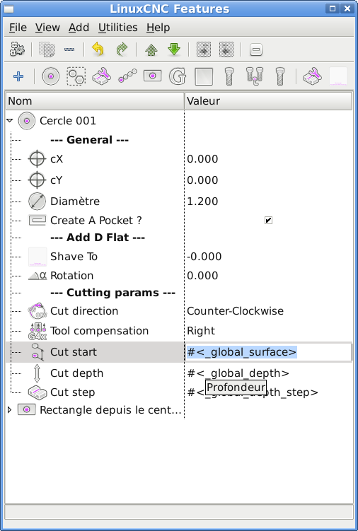

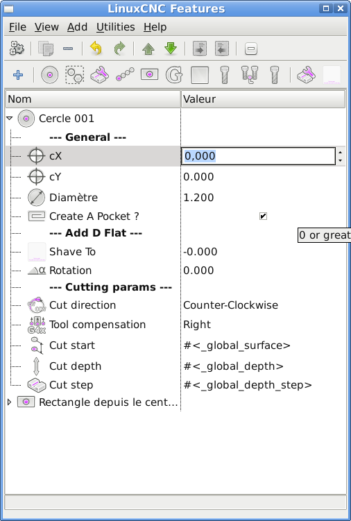

Here are my screen shots with the widgets in the treeview
Best Regards
Fern
Nice!
Are those subsections --General-- --Add d flat--- are collapseable?
Aren't they to much for every subroutine?

12 Mar 2015 20:49 - 13 Mar 2015 19:30 #56743 by FernV
Replied by FernV on topic LinuxCNC Features - a kind of NGCGUI
Hi Nick,
No, those headers are not collapsable.
Simply add :
[PARAM_H1]
type = header
value name = <b>--- General ---</b>
that is all.
IMHO it helps readability
Regards
