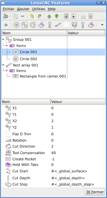

I would like some feedback on this one
The top treeview shows the structure of the job, while the bottom one shows the params of the selected one
Tell me if you think it is a good or bad idea
Regards
Fern

But I am using a mouse. not a touchscreen.
So do I
I think, the original one is better for touch screens.
So can we have both? Selectable vie commandline parameter?
Yes, both are available. I left the menu as standard because I think this is what most
people will use with the larger icons even with a touch screen.
The "top_features toolbar" is also standard and the add "+" button
is available only when USE_ICON_VIEW_DIALOG is set to True in features.py
Images can be resized easily let's say to 80, 90 or any pixels size that best suit your display
Same for icons in the menu.
Catalog 'mill.xml' is the same everyone actually use except for this change :
you add <SEPARATOR/> where you want some in the menu.
This line is ignored while building the dialog.
One change in the "top_features toolbar" is that you decide how many TOP features you want
in the left part of the separator and they do not show twice. The TOP are cumulative use
and will change much in the beginning while the others are the other ones you use in the session.
The usage file is saved in the catalog folder as "catalog_name.xml".use

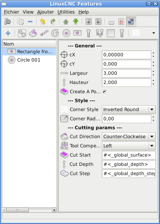

Your windows with the two treeviews is also a good idea.
The only problem I see there is, that on low resolution screens, the height of the
display may be too small to use it. Can the bottom treeview part be moved
right of the top one (also switchable via commandline parameter or config file)?
Yes it can be easily done, will I implement this ?
Placing it on the right would mean to resize Features
(a dialog to configure this is already accessible via a menu even when it is embeded in LinuxCNC).
If you have a low res screen, It may then leave not much space to see the result.
The purpose of Features is to create ngc code easily while seing the result immediately after any changes.
What I am planning is a button that would switch from 2 views to a single one and back.
When in 1 view mode, PARAMS would all be available to modify in the view,
and in dual mode params are only in the bottom one and only the COMMENT is editable in the top view.
(Last mods planned is the use of other widgets in the bottom view, like checkboxes, comboboxes, spinners,
etc. by only changing the param "type" in ini files. When done I think the interface will be the best it can be, or will it?
Who knows what new ideas someone can come up with ?)

Hi Nick,
I think this is the best option. When you have treeview for both the features and parameter you can navigate
and change everything very quick just using the keyboard, which is not so easy for two veiws.
Instead of a button, I will have a View menu with options for 'Single View', 'Dual View (Top and Bottom)' and
'Dual View (Side by Side)'. People will select what they want and it will be done on the fly
I agree that a single treeview is easier to navigate with the KB, I forgot to try to switch from one tree to the other with TAB

28 Feb 2015 01:08 #56341 by FernV
Replied by FernV on topic LinuxCNC Features - a kind of NGCGUI
Hi Martin
Hi Fern,
Your idea of having it side by side is a very good one. It is much, MUCH, MUCH better... If you have a wide screen.
This is my work computer with 1600 X 900 screen.
(Please do not pay attention at the fake job there, it is just to give an idea how it is to work with it)
Best regards
Fern
02 Mar 2015 14:38 #56393 by turbospeedskater
Replied by turbospeedskater on topic LinuxCNC Features - a kind of NGCGUI
Hi Fern,
Hi Nick,
wow... looks great. I think I have to buy a 16:9 screen for my milling machine :-)
