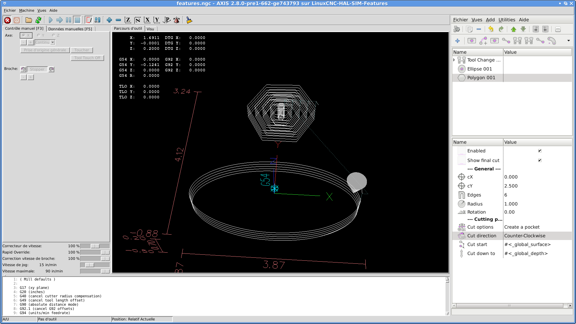

24 May 2015 03:23 - 24 May 2015 03:34 #58959 by FernV
Replied by FernV on topic LinuxCNC Features - a kind of NGCGUI
Hi Nick,
I did not have much time lately to work on the new version, however I completed debugging (only one bug I could not find a work around).
I updated most of my features to take advantage of the new version.
You can see an ellipse and a polygon that is pocketed.
All my features (Rectangle, circle, slots, radial slots, ellipse and polygons) can be cutted clockwise or counter-clockwise, cutted inside or pocket, outside or without compensation.
Here is the general help file (Sorry, it would not upload)
I am willing to share all my work but am not very familiar with git-hub. However I think I have an account.
What do you say about this ?

25 May 2015 17:07 #59000 by Nick
Replied by Nick on topic LinuxCNC Features - a kind of NGCGUI
Looks great!
Where can we get it? :)
