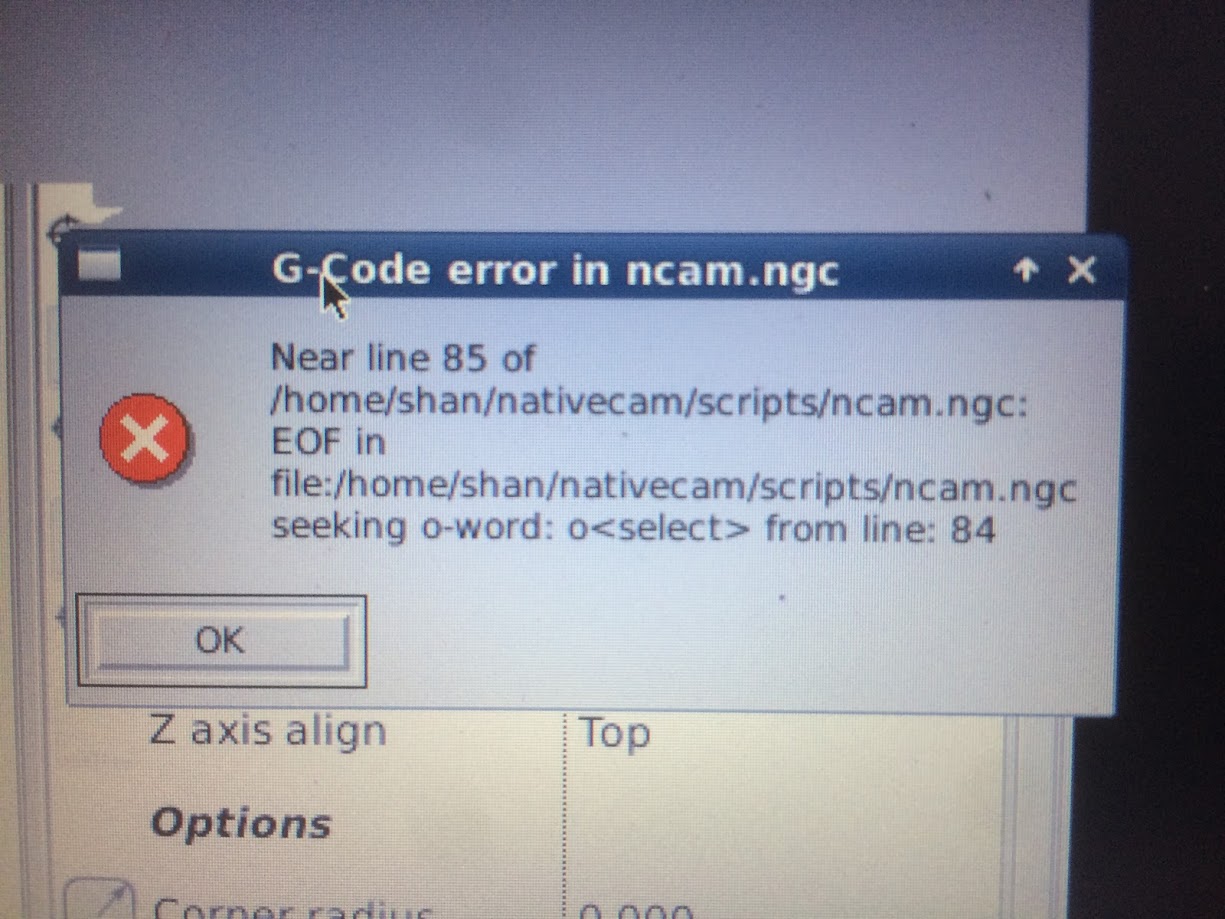

- roboylabs
- Posts: 2
11 Mar 2017 02:21 #89393
by roboylabs
Replied by roboylabs on topic NativeCAM is Features renamed
When I run NativeCAM, I get this error message.Pls help.
- FernV
- Posts: 457
- Thank you received: 124
11 Mar 2017 16:11 #89422
by FernV
This happens when select.ngc was not copied yet because you took too long to confirm you want the files copied to the disk.
Just restart.
Fern
Replied by FernV on topic NativeCAM is Features renamed
Just restart.
Fern
