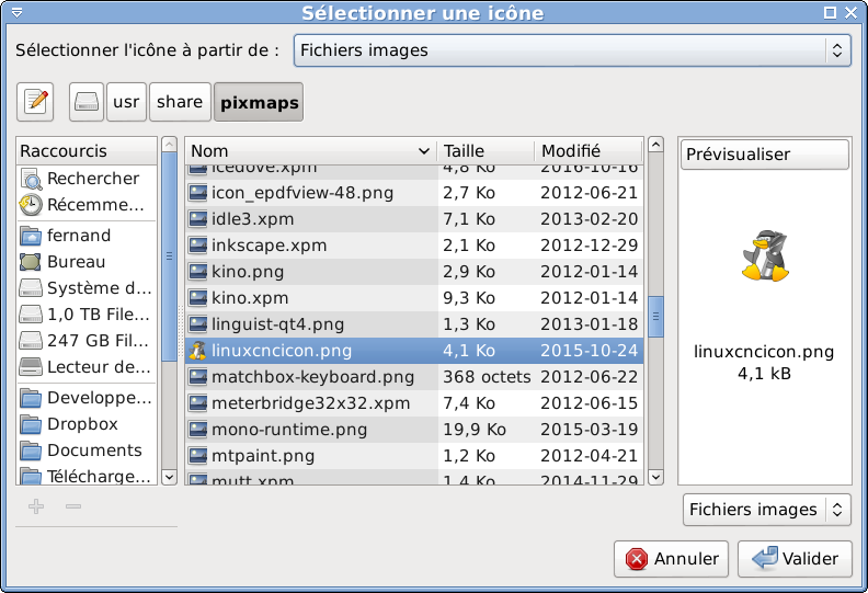

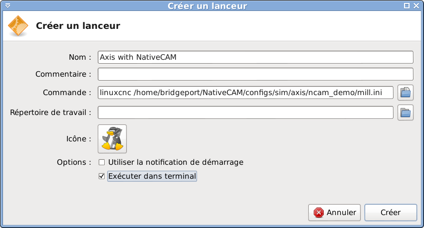

I have NativeCAM working embedded by launching it from the terminal like the instructions show. I first change to the NativeCAM directory then enter the command you show for mill.ini, linuxcnc with NativeCAM launches nicely.
What I would like to do, and have not had any success is to create a desktop launcher to do this so I don't have to open terminal, change directories and enter the starting command every time. I have not had any luck getting this to work. I believe its a matter of paths to the various files not being found.
Any suggestions on creating a desktop launcher for embedded NativeCAM?
Thanks,
George

26 Nov 2016 07:55 #83329
by FernV
It is not very difficult. Right click anywhere on your Desktop and select 'Create Launcher...'
Fill like this
For the icon, select a file like this
Fern

27 Nov 2016 17:27 #83369
by gmouer
Replied by gmouer on topic NativeCAM is Features renamed
Hi Fern,
Thanks for the great help in creating a desktop launcher to NativeCAM. It worked great !
I had the process right before your help BUT for some reason I insist on spelling ncam as nccam ! Obviously that causes problems !
Also, I successfully set up a config with NativeCAM for my bridgeport mill. I look very forward to learning it and using NativeCAM on a regular basis.
Thanks so much for all your work and help.
George
