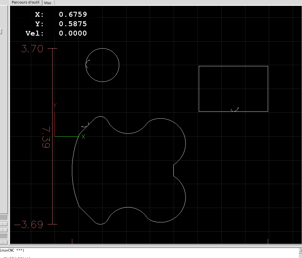

Hi
I did some modifications to the code in order to get it working in my plasma
I removed all Z related, in the .cfg, and .ngc files.
it works ok, however, I have some doubts about the modifications.

I think the most important thing is you do not have a "lead_out" subroutine. I am working on it and have a few issues to resolve before releasing it. However, when you clone the new version, NativeCAM will ask to copy the new files over the ones you edited. If you want to keep your files, you will have to select the right action in the copy dialog. You can not just rename the "plasma" sub-dir. (I may make changes in a future release to make it possible)
Fern

I just uploaded an update for plasma that includes a lead_out subroutine and many minor corrections.
To use with a plasma cutter you need a THC configured but you can test without it. In Preferences/Plasma tab is a checkbox that must be unchecked to use the configured THC.
Load the demo
The files uploaded use only X and Y axis but if for any reason you need to control a Z axis, simply remane catalogs/plasma/_menu-custom.xml to menu-custom.xml which will be loaded instead of the default menu.xml
Also it is very important that your ini file defines all 3 axis and you use core_sim.hal instead of core_sim2d.hal and simulated_home.hal instead of simulated_home2d.hal
When loading for axis interface in 2d, you will have an error message that says z is used because I think it tries to load the 'LinuxCNC' engraver ngc file. I do not know how to remove it
Happy testing
Fern
