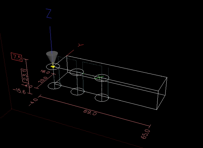

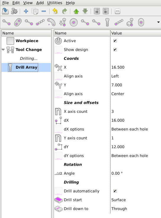

- franstrein
- Posts: 27
29 Dec 2016 13:45 #84850
by franstrein
Replied by franstrein on topic NativeCAM is Features renamed
Handling of Drill Array in NativeCam
I added recently NativeCam to my gmoccapy setup for my Deckel FP1 mill. It looks good, and I am trying to get a better understanding. One of the first operations I needed, was using "Drill Array". However I doesn't give the results I expected:
In a workpiece of 65*16*12mm , I plan to drill 3 holes, at x coordinates 16.5, 32.5 and 48.5, and all on y coordinate 7. These are references from the front left corner of the workpiece.
However the generated g-code appears to be done for (0,0) . (16,0) and (32,0) coordinates.
The screenshots below are from my simulated VMWare environment, but on the real machine simular results happen, and even start drilling at (-16,0). That might be due to the coordinate system used?
What am I doing wrong here?
Thanks,
Frans
Thanks,
Frans
