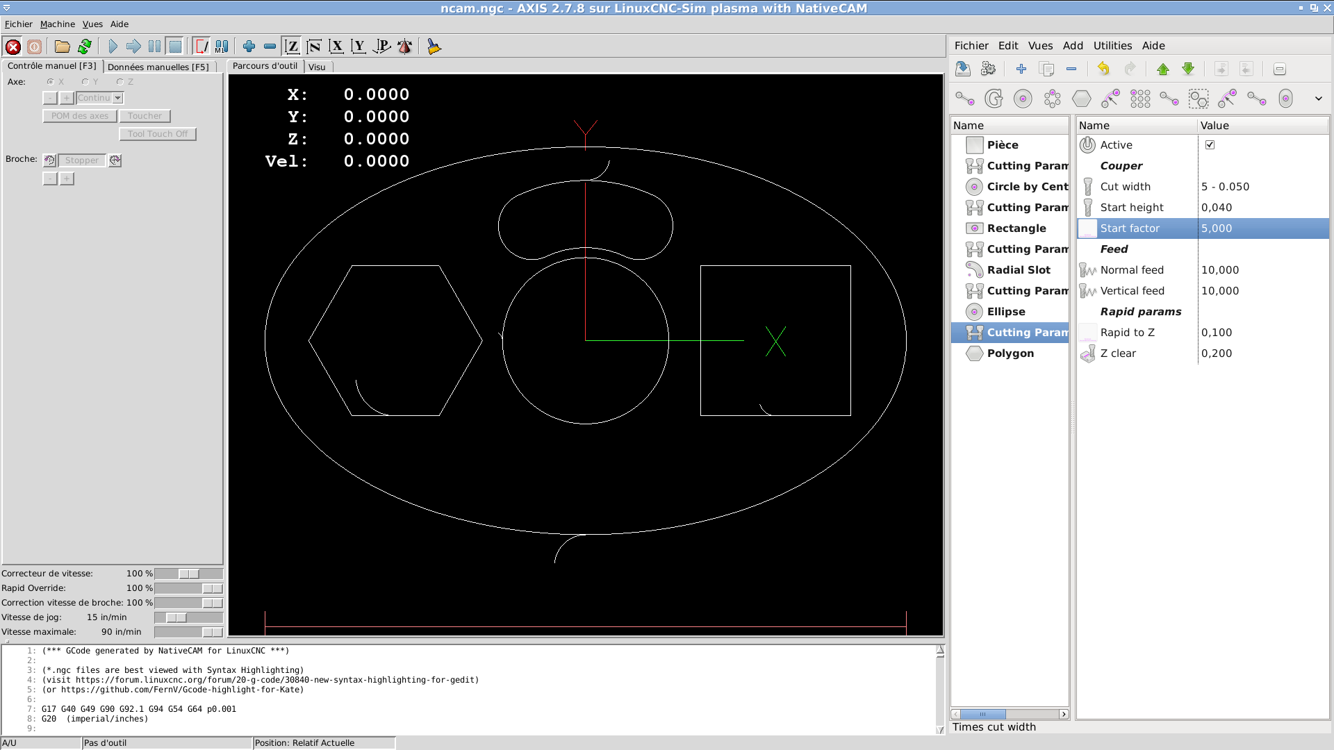

Hi Fern,
I installed ubuntu 10.4 (fresh install with old_archives repositories) + Linuxcnc 2.7.8 on three different computers and unfortunately NativeCam does not work on any of the three. I do not know if anyone else has had a similar experience.

Have you read my previous post : forum.linuxcnc.org/40-subroutines-and-ng...amed?start=110#82784
Your post does not bring any element to help solving your issue

I see it can be done inside and outside for every piece ! Nice.
I will try to install and run on a plasma cutter, but it is far from town do i have no internet there except on my phone. Can it work under 10.04 and 2.5 ? Never mind, i will try it and if it does not, i will install a newer version and make it work here and then move the hdd there.

Hi Fern, Ubuntu 10.04 crashes everytime I try to run the updated NativeCAM.

Engraving for NativeCAM should hopefully be ready by the end on January.
Meanwhile, your best is to use ngcgui

I installed Ubuntu 10.04 from iso image on lcnc web site and my pc does not connect to any network with it, I was unable so far to configure it to work yet.
I recommend you stay with Wheezy as it works great with it.
Regards
