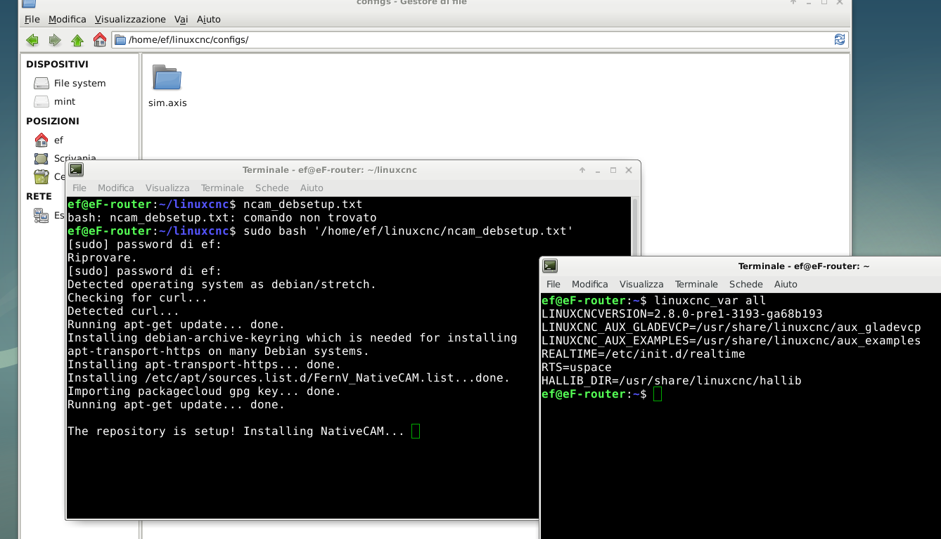

27 Jun 2017 09:08 - 27 Jun 2017 09:11 #95028 by eFalegname
Replied by eFalegname on topic Use NativeCAM as a deb package now
Hi Fern,
I updated my linuxcnc to the master version 2.8 on debian 9. The NativeCam install runs flawlessly, but I don't know how I do start it...
Cheers
Floris

27 Jun 2017 12:49 #95042 by FernV
Replied by FernV on topic Use NativeCAM as a deb package now
Hi Floris,
Run first :
$ linuxcnc_var all
If the result has :
LINUXCNC_AUX_GLADEVCP=/usr/share/linuxcnc/aux_gladevcp
LINUXCNC_AUX_EXAMPLES=/usr/share/linuxcnc/aux_examples
then your version can use the deb.
In any directory type :
$ ncam -h
Fern

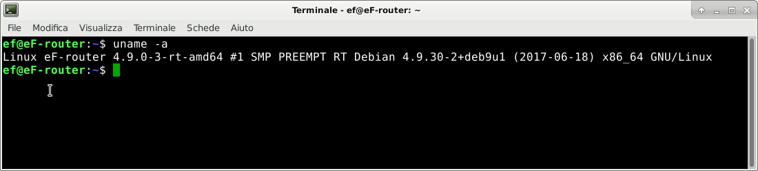

27 Jun 2017 13:26 - 27 Jun 2017 13:35 #95046 by eFalegname
I'm in the same situation as tecno, too much installation time and nothing about Native Cam.
Last edit: 27 Jun 2017 13:35 by eFalegname.
