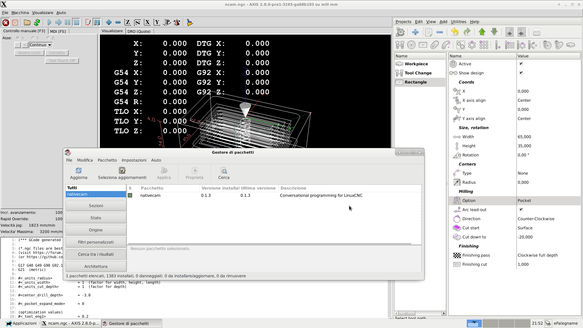

- eFalegname
- Posts: 252
- Thank you received: 30
27 Jun 2017 19:58 #95071
by eFalegname
Replied by eFalegname on topic Use NativeCAM as a deb package now

Been fighting to install the deb on Linux Mint 18.1 only to find the reliance on truetype-tracer which is not available as a deb from anywhere I could find. So I downloaded the source and compiled it but nativecam still complains. Can I then still install from git or is there a workaround for the deb?

Got it to work by installing nativecam without the dependency of truetype-tracer which I then installed later. All running now on Mint 18.1 64 bit RIP 2.7.9

Hi Fern
The biggest issue I see is the forced truetype_tracer dependency, Mint 18 does not have it available. So to get around that I downloaded a 32 bit deb of tt-t and installed that then tried nacm. Didn't work as ncam said it still needed tt-t. So I then removed tt-t again and installed it from source. That didn't work either.
In the end I downloaded the Ubuntu Trusty deb from you and forced the install with dpkg --force-all -i (installs without missing dependencies) and it worked. I then reinstalled tt-t and so far all is well. I have followed the usual directions to get ncam running embedded in gmoccapy. As as side note I probably will never use Truetype tracing as I use Vectric Aspire and Fusion 360 for my CAM work so the requirement to install it alongside ncam, for me, was un unnecessary distraction.
Now all I have to do is work out how to get ncam to start up with a blank screen, my copy of gmoccapy complains the it can't be in one of the modes until I get it out of estop, either MDI or AUTO. Can't remember that bit as I have pulled the computer apart to replace the case and power supply.
Hope that helps in some way.
