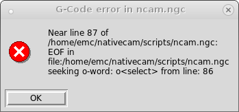

05 Jul 2017 15:56 #95397
by rene-dev
Replied by rene-dev on topic Use NativeCAM as a deb package now
Im trying to get this to work with sim/axis_mm.ini from linuxcnc master.
I ran /home/emc/dev/NativeCAM/ncam.py -i axis_mm.ini to change the ini file.
when starting, this happens:
emc@emc:~/linuxcnc/configs/axis$ linuxcnc axis_mm.ini
LINUXCNC - 2.8.0~pre1
Machine configuration directory is '/home/emc/linuxcnc/configs/axis'
Machine configuration file is 'axis_mm.ini'
Starting LinuxCNC...
Found file(lib): /home/emc/dev/linuxcnc/lib/hallib/core_sim.hal
Note: Using POSIX realtime
sched_setaffinity: Invalid argument
Found file(lib): /home/emc/dev/linuxcnc/lib/hallib/sim_spindle_encoder.hal
Found file(lib): /home/emc/dev/linuxcnc/lib/hallib/axis_manualtoolchange.hal
Found file(lib): /home/emc/dev/linuxcnc/lib/hallib/simulated_home.hal
note: MAXV max: 53.340 units/sec 3200.400 units/min
note: LJOG max: 53.340 units/sec 3200.400 units/min
note: LJOG default: 30.480 units/sec 1828.800 units/min
note: jog_order='XYZ'
note: jog_invert=set([])
(gladevcp:11321): libglade-WARNING **: Expected <glade-interface>. Got <interface>.
(gladevcp:11321): libglade-WARNING **: did not finish in PARSER_FINISH state
**** GLADE VCP ERROR: With xml file: /home/emc/dev/NativeCAM/ncam.ui : could not create GladeXML object
<commandline>:0: gladevcp exited without becoming ready
Embeded tab command "halcmd loadusr -Wn gladevcp gladevcp -c gladevcp -x 50331808 -U --catalog=mill /home/emc/dev/NativeCAM/ncam.ui" exited with error: 1
task: 1216 cycles, min=0.000013, max=0.005653, avg=0.001100, 0 latency excursions (> 10x expected cycle time of 0.001000s)
/home/emc/linuxcnc_debug.txt
and
/home/emc/linuxcnc_print.txt
as well as in the output of the shell command 'dmesg' and in the terminal

- FernV
- Posts: 457
- Thank you received: 124
05 Jul 2017 16:46 #95399
by FernV
Replied by FernV on topic Use NativeCAM as a deb package now
It does not seem you are using the deb package, are you ?
Fern
Fern
