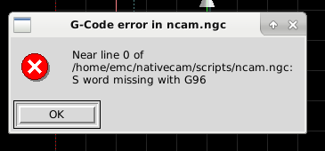

- rene-dev
- Posts: 50
- Thank you received: 27
20 Nov 2017 21:10 #102106
by rene-dev
Replied by rene-dev on topic Use NativeCAM as a deb package now
- FernV
- Posts: 457
- Thank you received: 124
20 Nov 2017 21:23 #102107
by FernV
Replied by FernV on topic Use NativeCAM as a deb package now
Hi René
G96 <D-> S- (Constant Surface Speed)
G97 (RPM Mode)
Open /home/emc/nativecam/scripts/ncam.ngc and find G96 and see if S follows this and it should not be 0. If 0 then in Tool Change see what speed you have entered for Constant Surface
(I am not near my computer and this was answered from memory, it may be other name)
Fern
G97 (RPM Mode)
Fern
